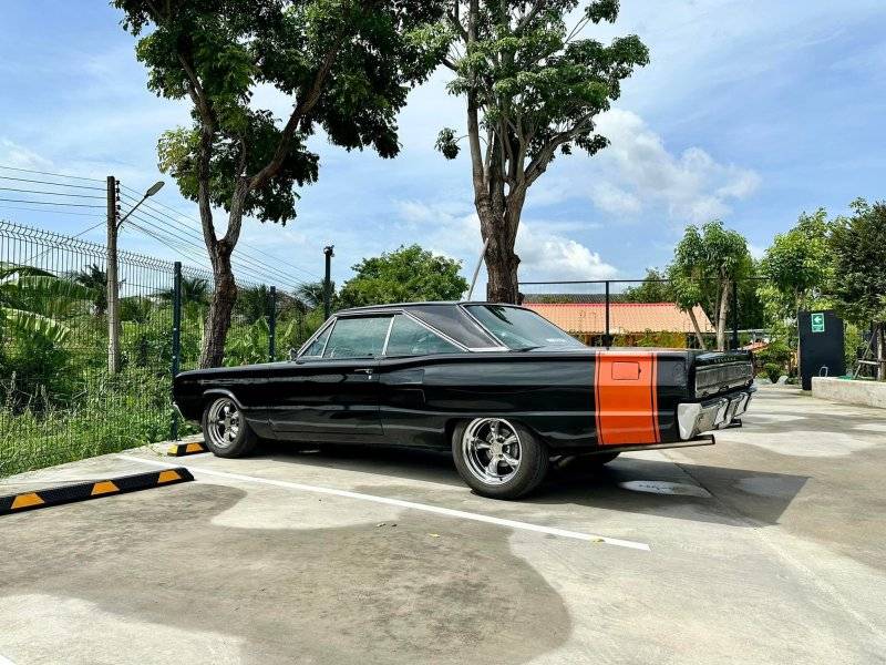

I have a friend in Bangkok Thailand with a 67 Coronet 2 door coupe that broke his driver’s door glass. Is the door glass on 67 Coronets the same for all 2 door models? Below is a photo of his car. Thanks!
