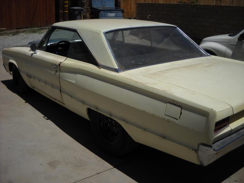

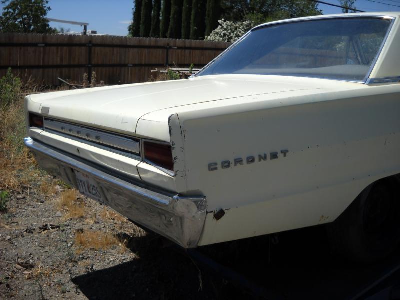

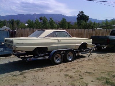

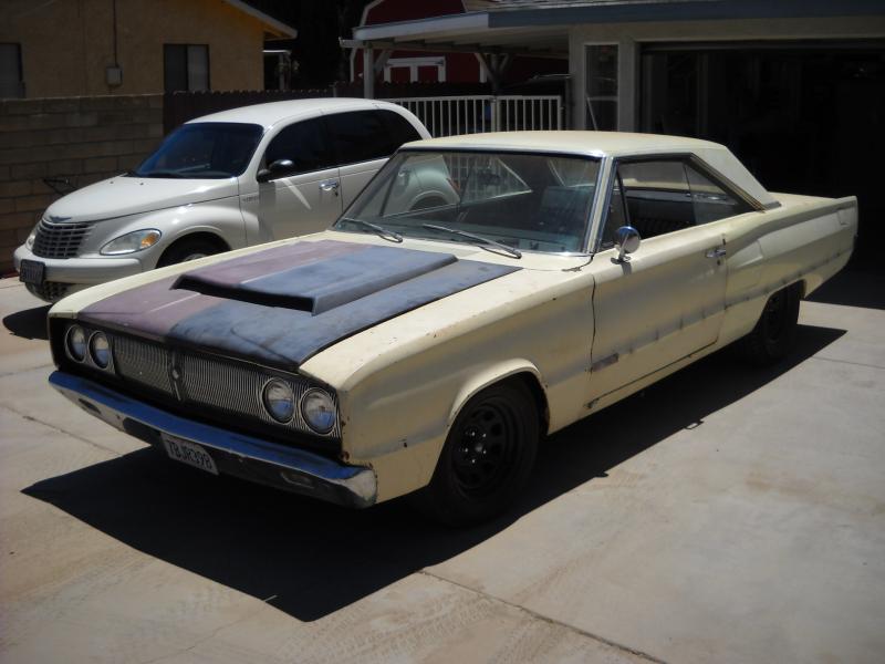

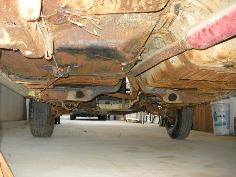

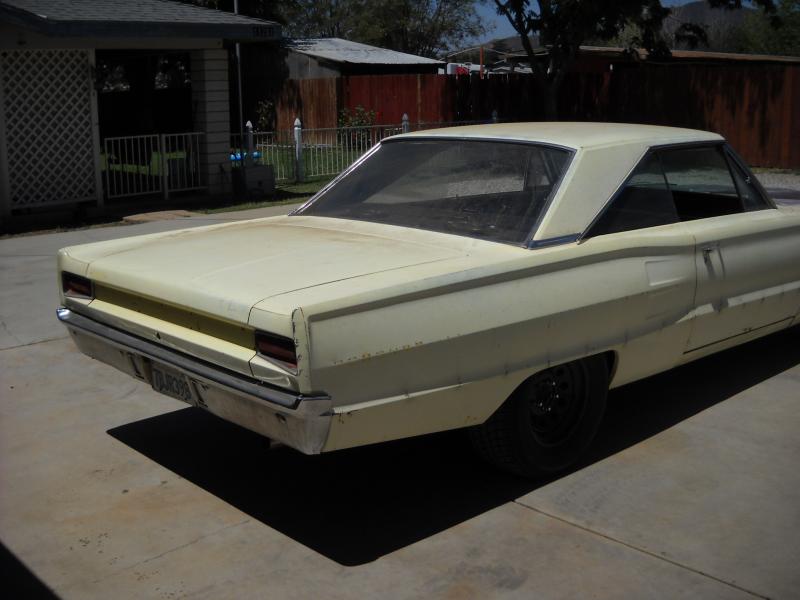

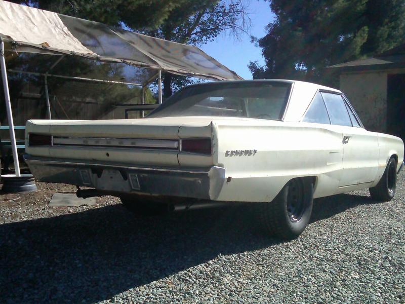

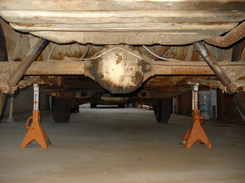

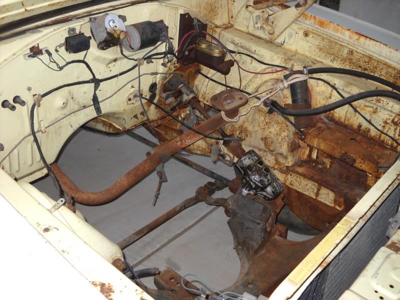

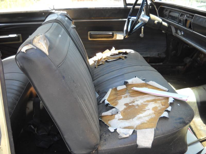

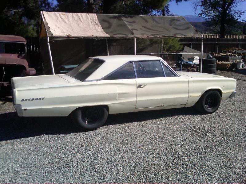

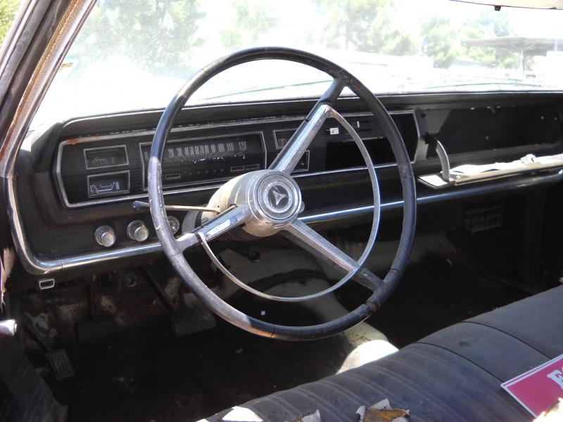

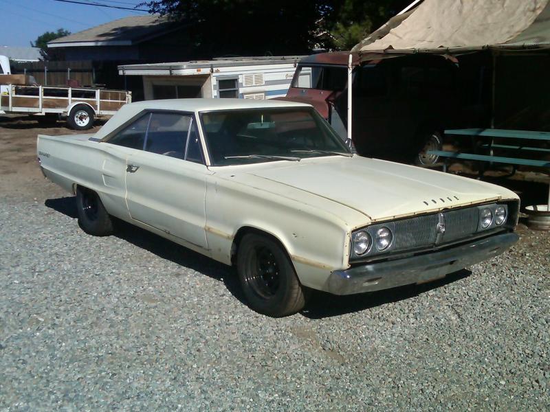

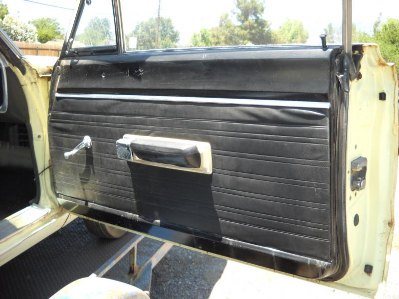

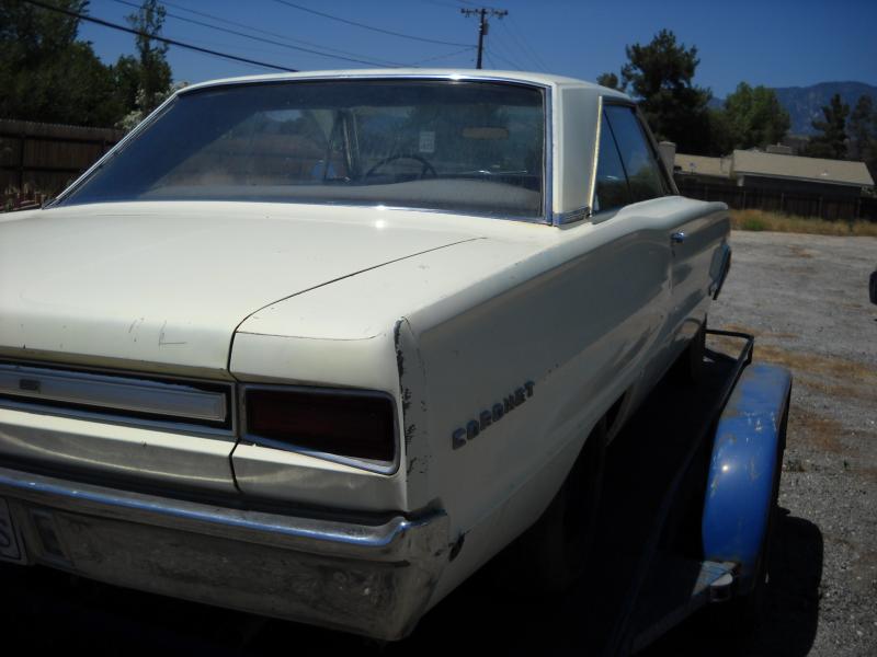

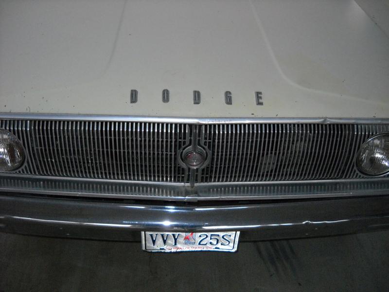

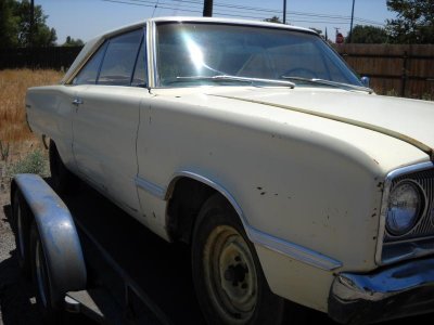

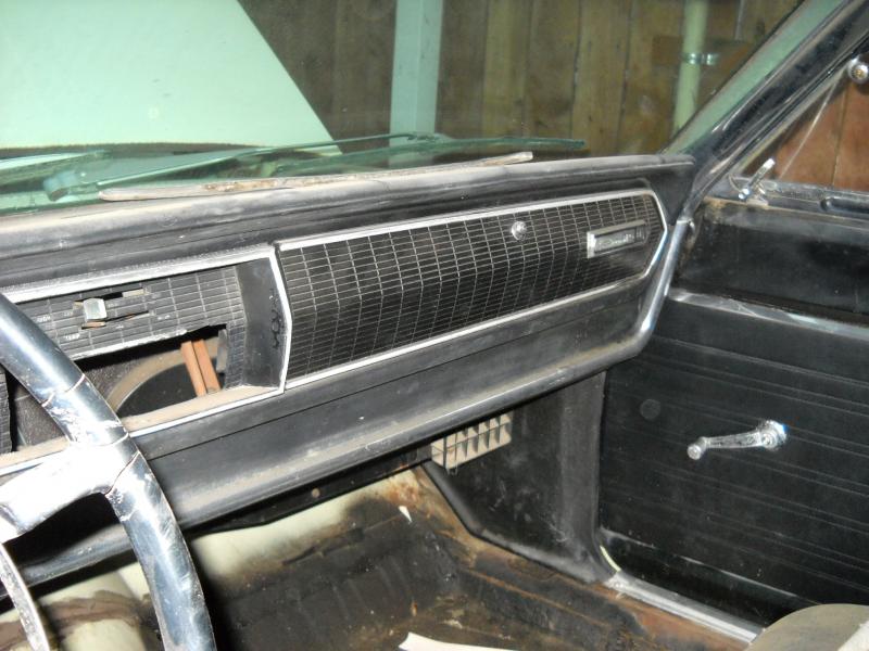

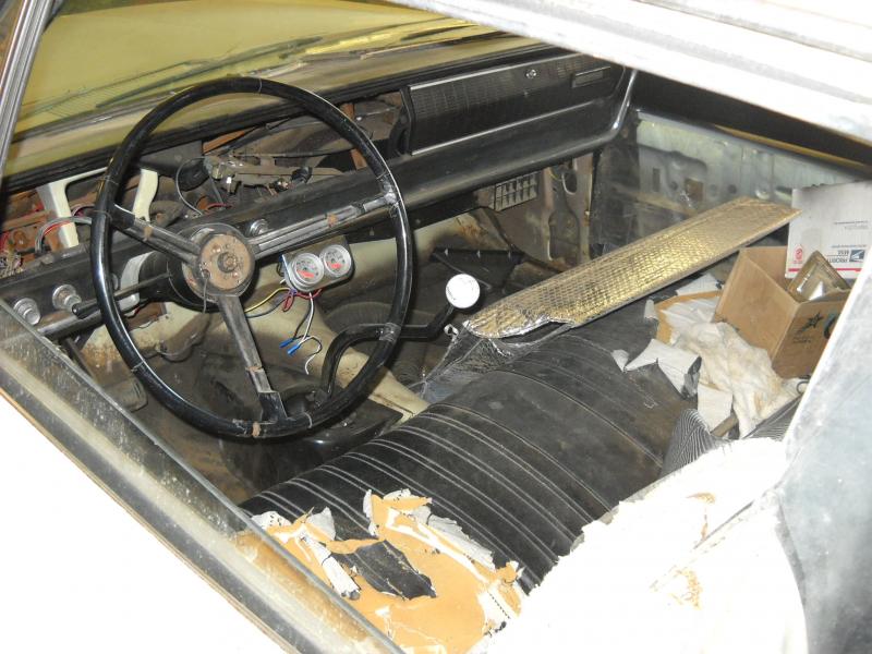

My Imperial project has been taking me away from the Dodge. The Dodge is back on the front burner. These pics are from '09 when I brought the car home. I was a 6 cyl 3 speed car.
Car looks pretty good for it's age. A few things here-n- there.
Great car "I'm a sucker for the 67's". So what's the plan for it?

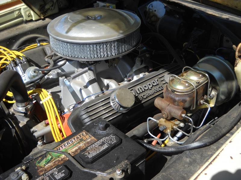

413 and a 4-speed
Is the plan.

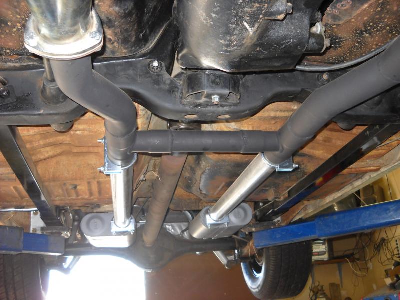

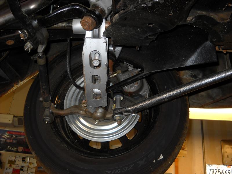

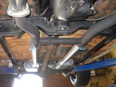

Progress

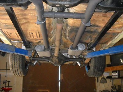

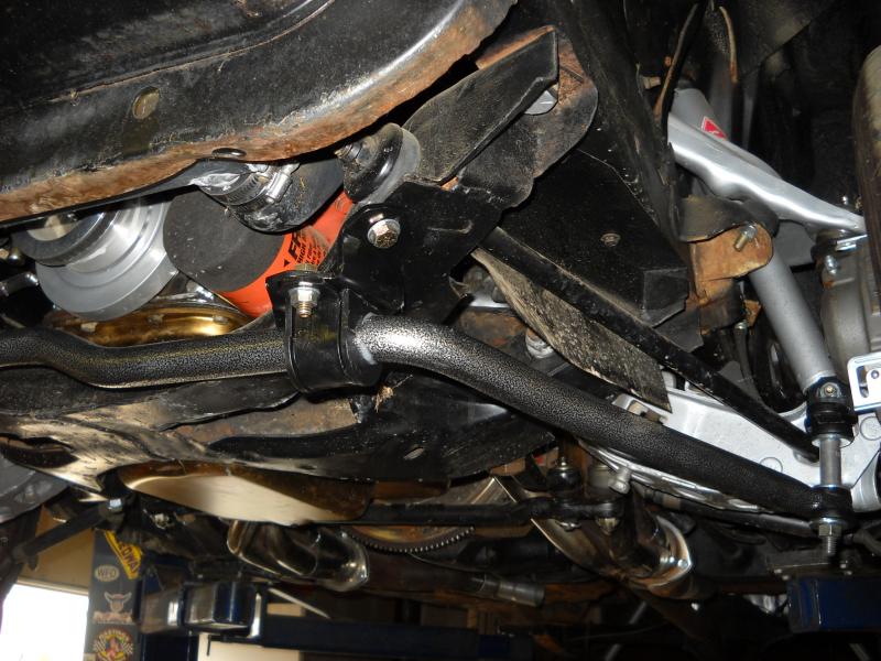

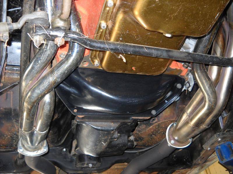

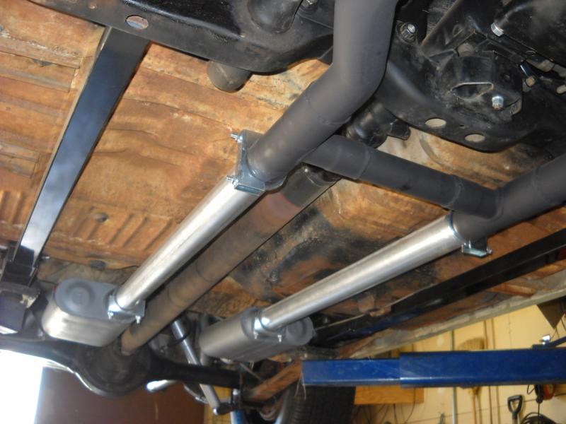

Exhaust, suspension making progress. Also welded in frame connectors.

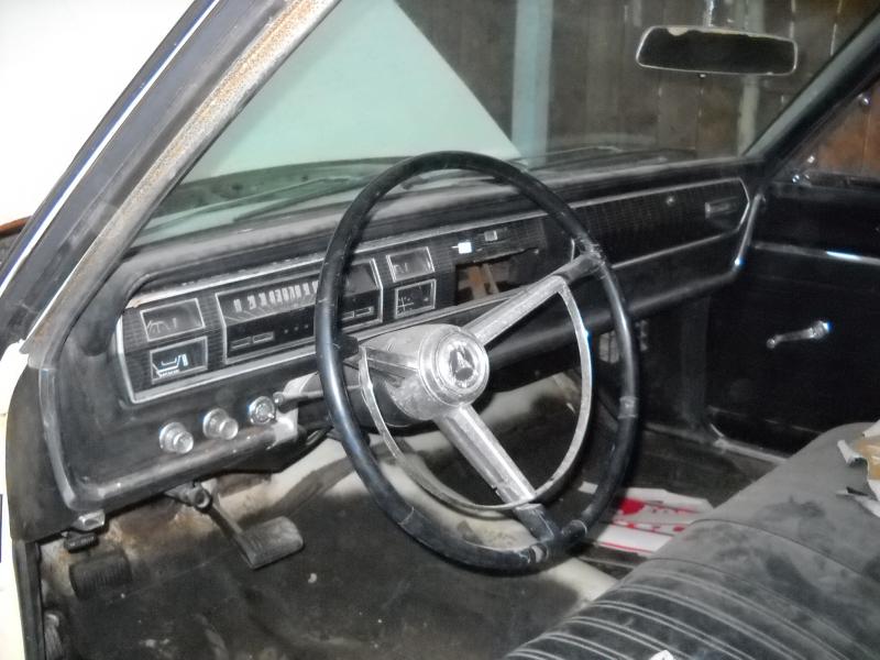

Looks good, im with 747, im a sucker for the body style of these myself, Last night i showed my wife a picture of the front end on one, all i got was "i don't get into the cars like you" Oh well, i love them all lol.. I see you have your instrument panel out, if you like the looks of the white instrument panel, check this out, its easy and cheap. Good looking car you have!
http://www.whitegauges.net/products/1966%252d1967-Dodge-Coronet-White-Face-Gauges.html

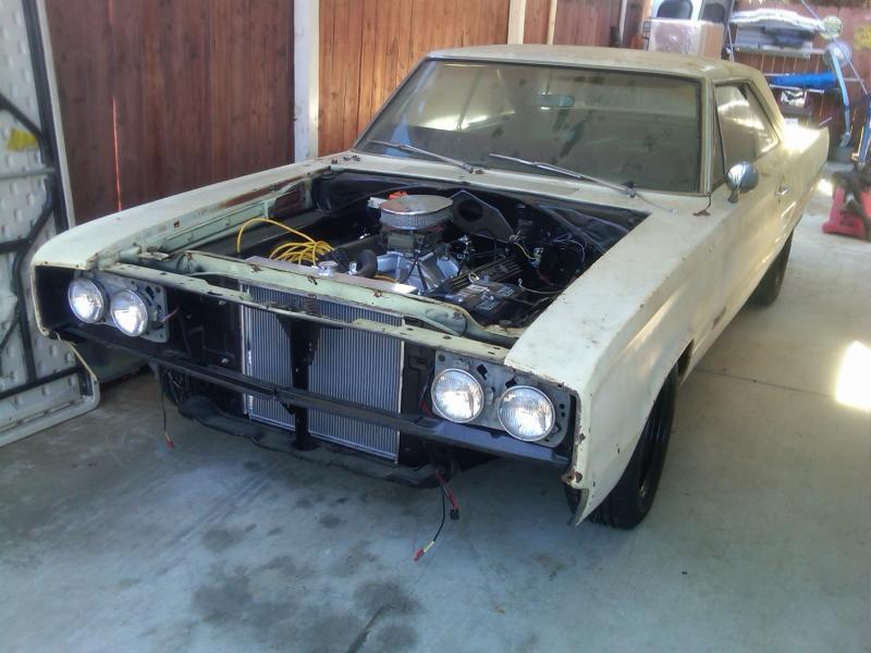

A few recent pics
I'm finally getting back to this project.

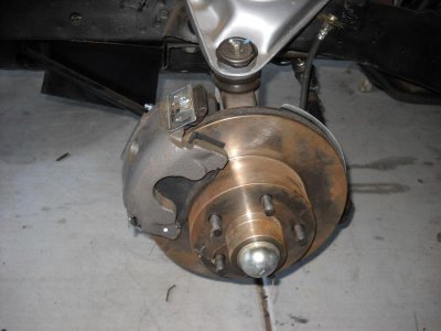

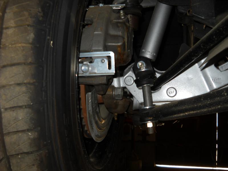

Who's disc brake package did you use or are they original stuff?
It was a package deal I picked up from a seller on EBAY. Easy install, works well.
http://i.ebayimg.com/t/62-72-70-74-MOPAR-B-BODY-E-BODY-COMPLETE-POWER-DISC-BRAKE-CONVERSION-KIT-SALE-/00/s/MzE1WDUwMA==/$(KGrHqV,!lcFCf0utqMkBQvBl23oGg~~60_12.JPG

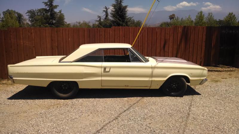

Now I'd say that sits about perfect ! Do you mind me asking what wheel and tyre sizes you are using ?
i'm with cman,you hit the stance and tire size dead on.what size and back space on the wheels as well as tire size if you dont mind.i am about to set up the tires and wheels on my 67 and that is the look i am shooting for.
I've got 15 by 8 BART wheels on the rear, 5-inch offset towards the inside. I'm running 275-60-15 Cooper Cobra Tires. Tight, but it fits. Fronts are BART 15 by 7 with 4-inch offset to the inside. Tires are 225-60-15.

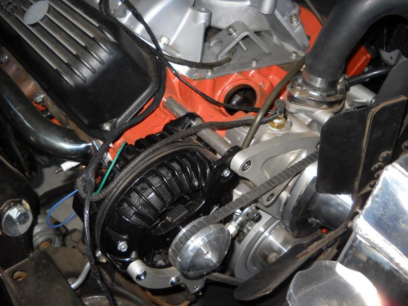

Here's a few misc. pics. (if they loaded) Jan 2012 misc 008.jpgIMG_20140720_120758351.jpgCoronet sway bar 012.jpgJan 2012 misc 002.jpg

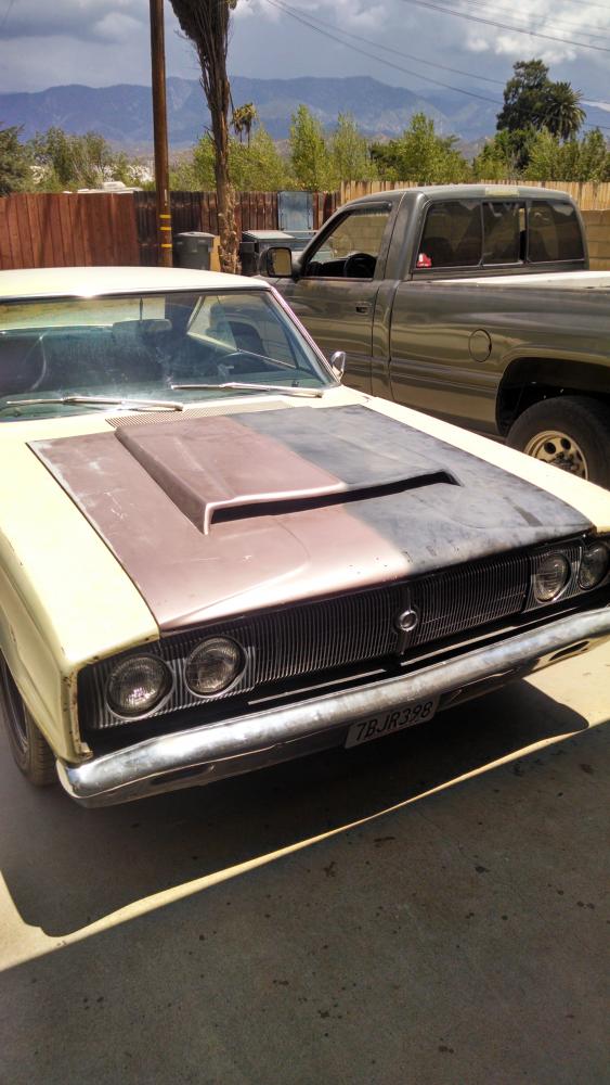

Phone July 13 033.jpgThe Coronet is in the body shop. I'm going with a 'clean?' almost trim free look. I removed all the trim mounting points and filled in all the holes except for the front edge of the hood. The body was pretty straight with only a few small dents. For the time being I will have the entire car done in primer black. I will make the final color decision later. (Probably a 2-tone)
