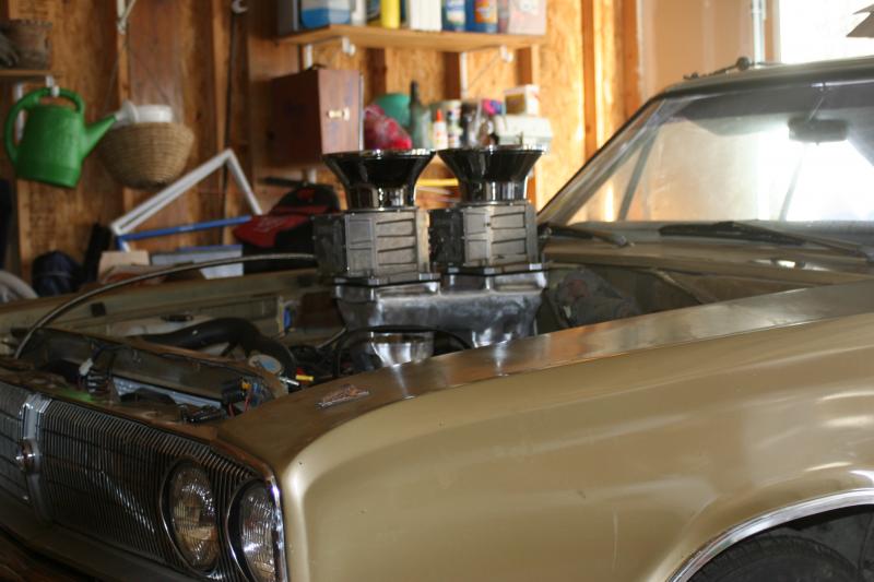

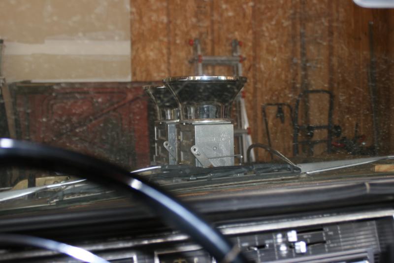

I bought a lot of performance junk to bolt to the engine. Toward the end of the year I will go ahead and do the engine. I bought the fuel cell, Holley black pump, -8 lines, MSD ignition, headers, 3" exhaust, 3000 converter, 3.91 rear, tunnel ram, predator carbs, and bolted all that to a stock motor home engine. I have been driving it and getting it all one piece at a time. I know its a stupid way of doing things, but it looks cool even though it really doesn't run any better than stock. And everything I have bought so far will convert over to the "real" engine I plan to make. It makes me smile and thats all that counts.
love the predators,prob the only reason that setup runs on a stock motor.i used to sell those back in the day,nice design,just had a tendencey to leak.
It ran great with just 1 of them. I am hoping it is better with the whiplash cam. Then I will go with a big cam when I get the bottom end to match. I am also in the process of changing to a 4 speed. I think it is going to be a handful for a street car.
We had a guy in the town where I grew up (Concord CA) with a 70 383 Challenger and a tunnel ram with a variety of carbs including the Predators. The car was pitifully slow for what was done to it (all show and no go) but I'll say this: He drove it everywhere and it did put a smile on his face, and it did look cool. He had the 2.76 gears and did everything to make it palatable to drive but I would have drawn the line on the clamp on wheelie bars (over the brake lines) and the strap on chrome rear end cover on the 8.75". We used to give him so much crap for having all that performance stuff and not being able to back it up. Damn shame. Eventually that car got a blower (under driven all to heck) and a mini tub and the gears were upgraded to 3.55's. It got in a magazine, which is what he ultimately wanted. I haven't seen him in years but heard from other sources he still has the car. So whatever you do pleeeeeaaaassseee do something to help back up all that coolness sticking out of the hood! It would just round out the package.
