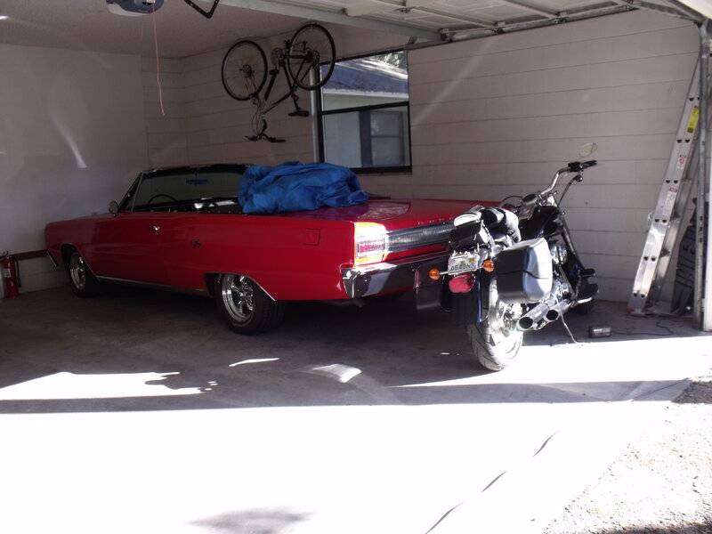

For all the time and money I spent forView attachment 1108365 8" wheels on the back, maybe 7 inch wheels all the way around would be much simpler.....With the backspace I had to use ( 5 1/4") the rear wheels do not look any wider or larger than the fronts..
You are right, it requires a very precise set of widths, back spacing, and tire sizing to make any bigger tire fit these cars.
