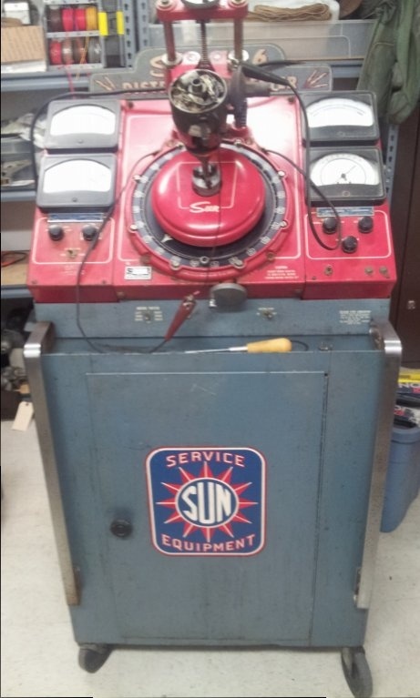

I'm assuming that the advance degrees in your post are at distributor rpm and have to be doubled for crank speed. That would give you 12.5 + 21 deg + 33.5 total initial and mechanical. You can probably bump the initial timing to about 14 or 15 and stay around 36 deg total.
However, the distributor in the car may not be original to it and may not resemble those figures at all. The only way to find out is to find someone with an old SUN distributor machine or get a dial-back timing light and map the curve yourself. The bushings were worn in my old 440 and I bought a NAPA rebuilt distributor to put in as my old one did not appear correct to the motor. Well, the NAPA one was even worse and pretty much confirmed that rebuilder just disassemble everything and throw the parts into big piles and just randomly select parts to rebuild from. No telling what you will get from them. The NAPA unit I got had about 28 or 30 degrees of centrifugal advance in it (crank rpm) which meant I could only run 6 to 8 deg initial timing and the car ran like a dog at low speed. I finally welded up the advance slots in the plate and filed them out to allow a total of 20 degrees centrifugal advance and I run initial advance of 16 degrees + vacuum advance. That pretty much transformed the engine.

It's pretty hard to find anyone with a working Sun Distributor machine anymore - maybe an older speed shop if there's one around. I doubt Precision Tune had any idea what they were looking at with a 67 GTX or anyone who could replace points.

67GTX440 if you're ever
in the area you're welcome to throw your distributor on the old SUN 506 and map the advance curve.
I'm 67,so yes I know how to use one.LOL. Easiest way to tuneup a Mopar was to just yank distrib out and set points on the Sun.no gear teeth to mesh like the "other" guys. Change advance springs and watch what they do--Great
