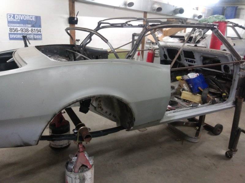

I am moving springs inboard and installing the 3 inch wider inner wheel tubs from AMD. The pic shows the wheel/tire combo that I would like to run. The wheels are a 15x12 and the tire shown is a Mickey Thompson 325/60R15. My question is will this work without other modifications?
I'm thinking you need to narrow the rear for that deep dish look
I'd put the wheel and tire where it belongs and measure between mounting surfaces
I did this with a Camaro; I stuffed an axel into a 3 inch pipe and laid it across the leaf springs; allowing me to slide it side to side to achieve the perfect fit
Thanks for the reply. I should have said that I was going to narrow the ale for the deeper dish look. I was more concerned about the tire fitting in the tub?
