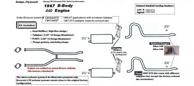

Is this the Accurate system same as yours?

Well, it looks like all the photos I've found of the tail pipe hangers look just like the ones on Year One's web site; even the ones from Accurate. I hadn't seen that photo on their web site. The price on the Year One pieces was $49.99/ea. but found the same part at Valley Vintage Auto Parts for $29.95/ea. Needless to say, I ordered from VVAP. I'll post an update when they arrive. I'm hoping for an "ah-ha" moment when I hold them under the car to see how they line up...
