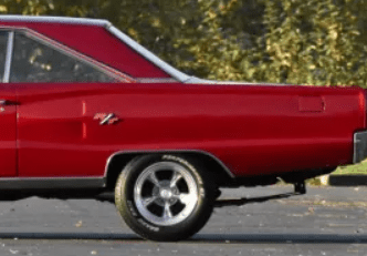

I would like the rear just high enough to expose the 15" Magnum wheels, but not excessively high (I used a jack in the rear to bring the height where I would like it).

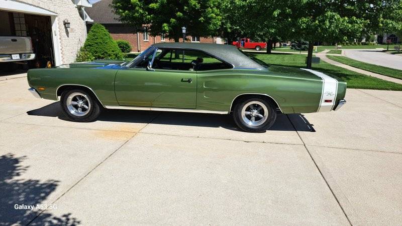

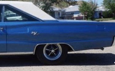

I like picture # 1 best. From a '67 R/T owner.
Yes...photo 1 is what I'm shooting for. Looks like I'll go with stock plus 1.
