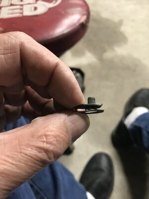

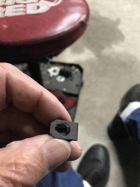

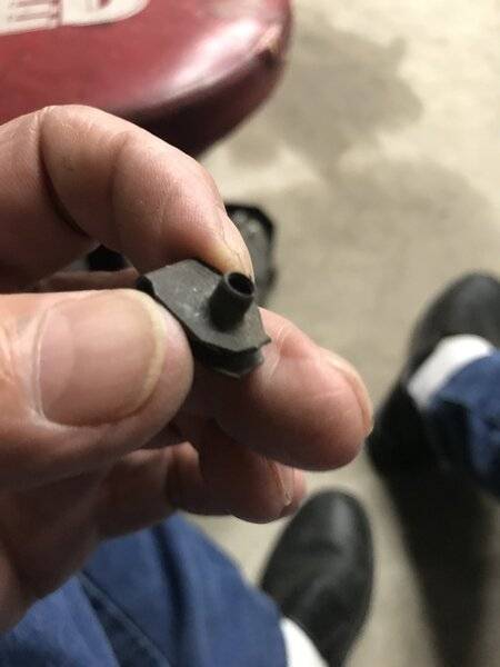

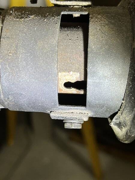

Ok here is my fix for the back up light switch, lever on 67 b-body’s column auto trans , simple and permanent! First pic , is the problem, second is the fix ! Screw a stud into the clip along with with an installed nut to lock down, once in position, tighten nut , done , add a piece of thin wall vacuum tubing over the stud to reduce wear ! Works great, and simple!
