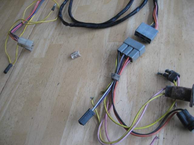

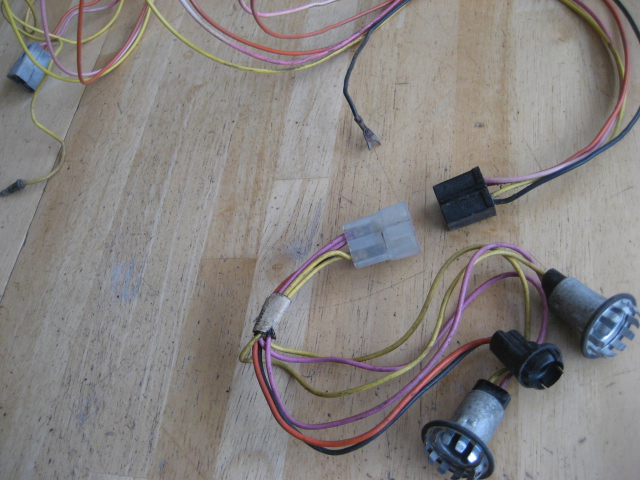

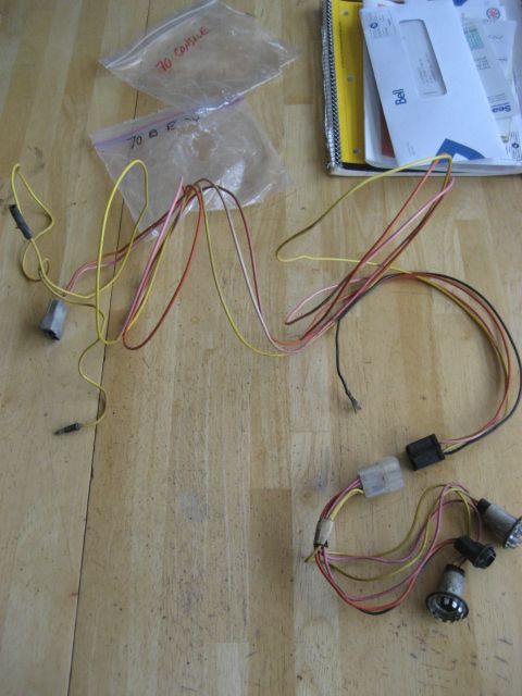

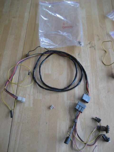

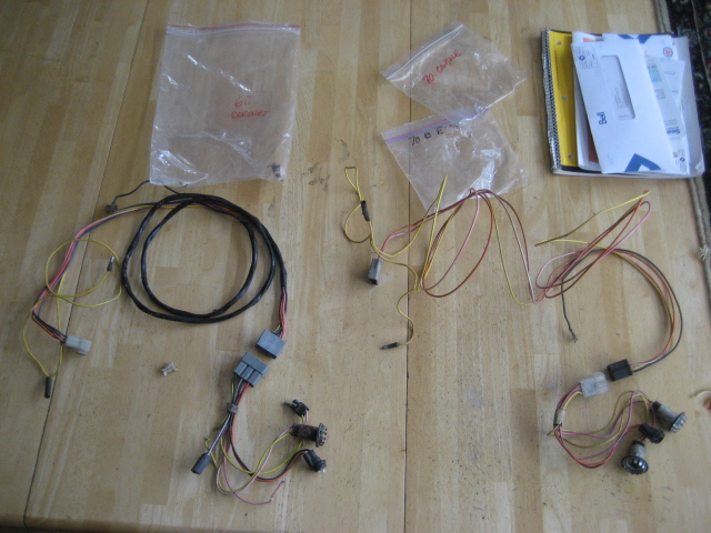

I have a complete A/T console harness from a 68 Coronet, from the post to the lights. I sold a complete harness exactly the same as this from a A/T 69 Road Runner , a few years back, No problems.
I have a complete 70 A/T harness that i removed from one of my 70 A/T Chargers ,a few years ago. They are definitely different harnesses.
Now i have a guy that wants to buy a A/T harness & i asked "What year?" He tells me there is no difference. I don`t want to sell him the wrong harness. What`s right & what`s not! Any input would be greatly appreciated.
Thanks FBBO

I could be wrong but one may be a standard cluster and the other is a ralley cluster setup. I am sure someone will be able to confirm this.
For the # guys & gals.
The 68 has a 2822 451 tag
& the 70 has a 2926 365 tag.
reverse light wire is in the 68 console, the 70 not so sure.
I know the door light and e brake yellow wire lenghts are different between a 67 and 68.
count the wires between the two and see what isnt connected to the main kick connect.
The second one pictured is the one I need, I've never seen the other before!
Tony
Like mentioned, The '68 and prior harness will have the two extra wires for hook up to the reverse light switch (Purple & White). '69 and newer does not, being the change with the 3 pin neutral safety switch. Either will work for '69 and on. '68 and below will need the harness in the second and third pic.
Good luck
