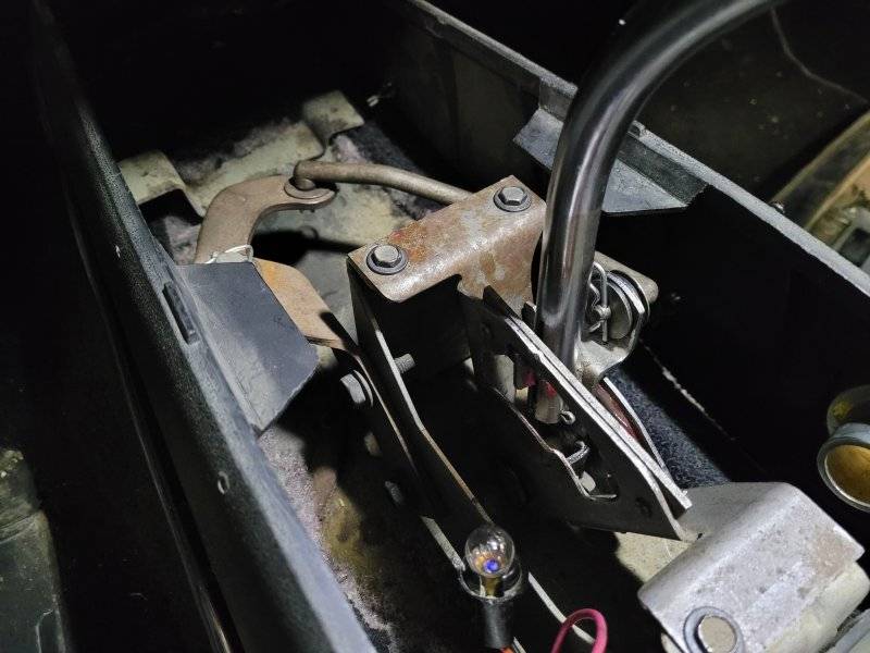

on second thought.........is this what you're looking for? this is the trans out of my 68
I'd say center (black dot) to center 3 1/4.........kinda tough with the stacked levers....... and reaching through a pile of ****
I think they might be the same lever as the linkage is all different for the lock out mechanism as it all stacks up at the lever. Here's what it looks like

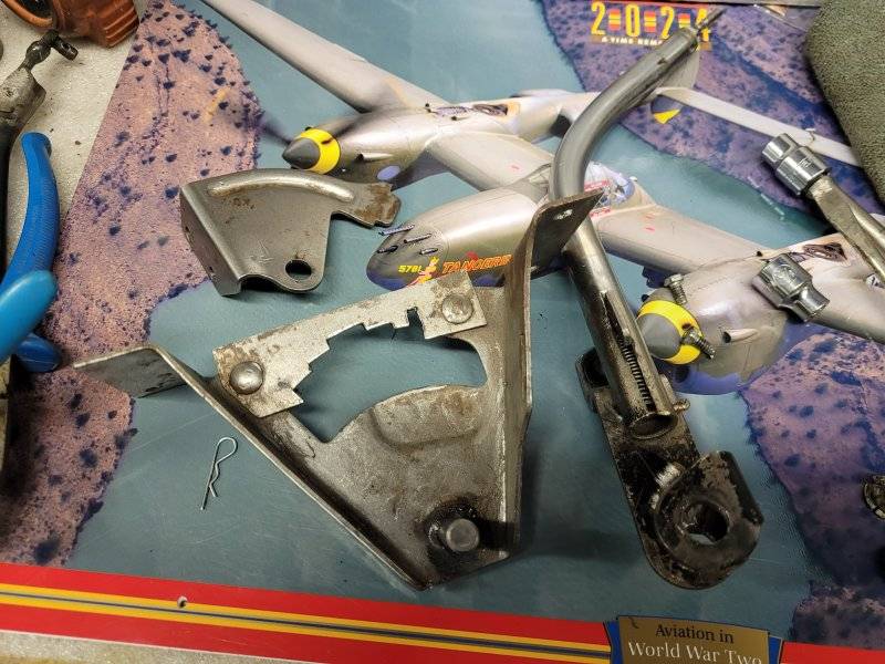

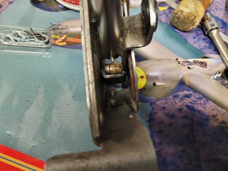

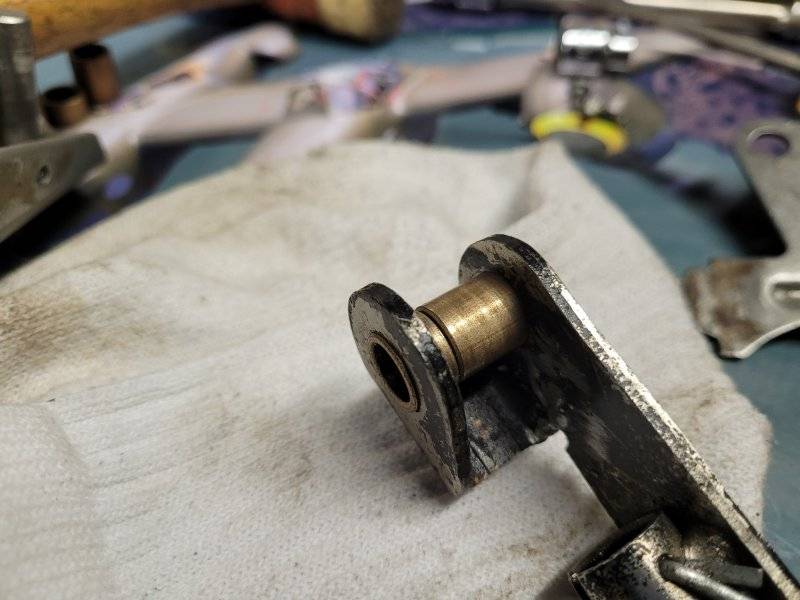

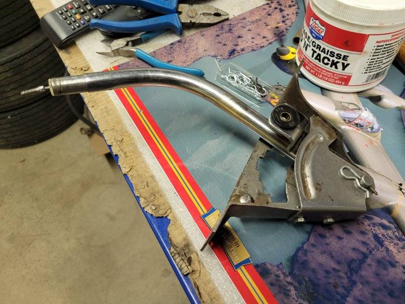

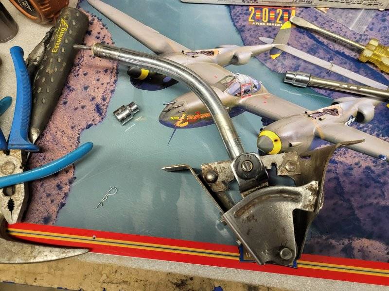

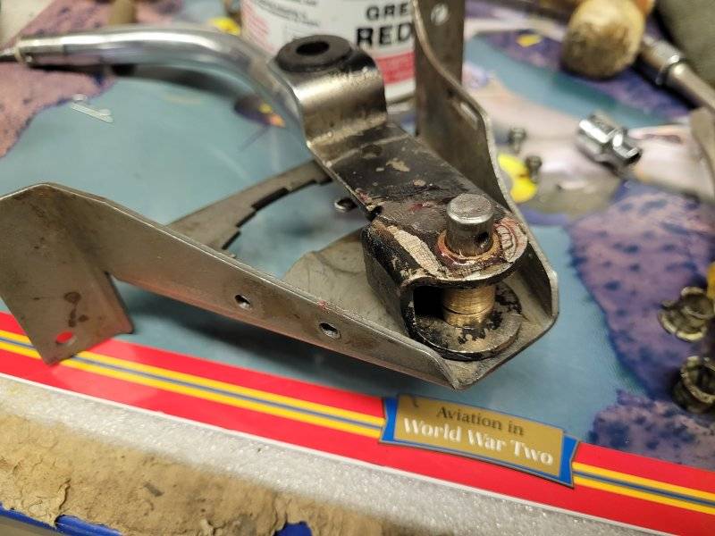

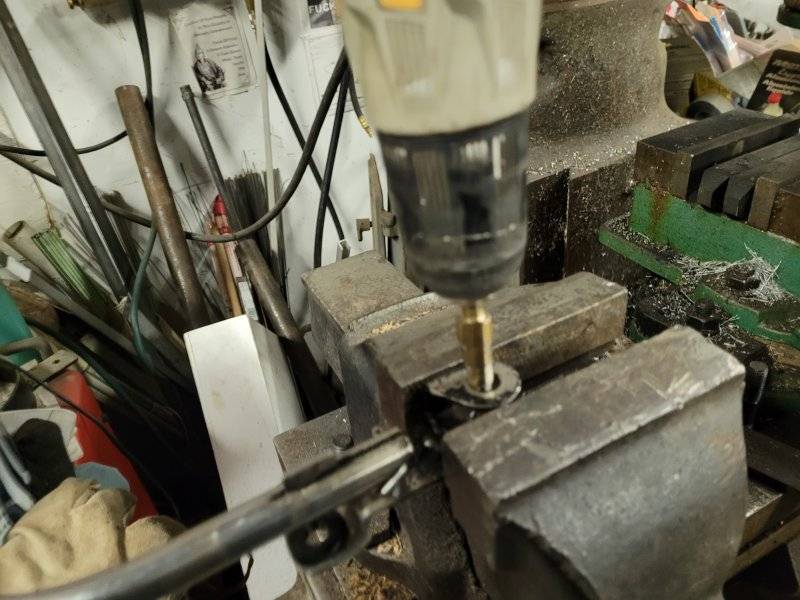

Went through the beat up shifter again. Straightened out the main frame some, slotted the removable plate holes so I could make it fit tighter and grabbed some of my bushing stock to take all the slop and play out of the shifter. That certainly changed things as I then had to lengthen the lever rod 3/16 to get positioning correct. Pouring rain, so test drive has to wait.

PM me your name/address/phone# and I'll send you 2 of the bushings I used for helping me out with pictures. Simple redrill at 1/2" with a uni-bit and they then tap in snug.
