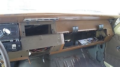

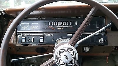

That dashboard is a high priority too. The only lights that work are oil pressure, and high beam (pretty dull red glow, but sorta there).
Looks like pulling the panel (since there's no dash cover presently) might be the easiest way.
