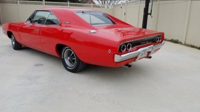

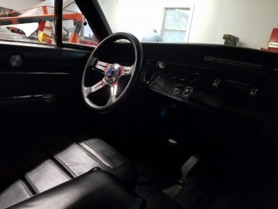

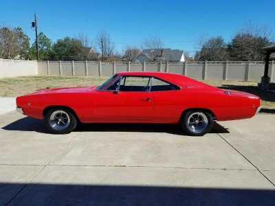

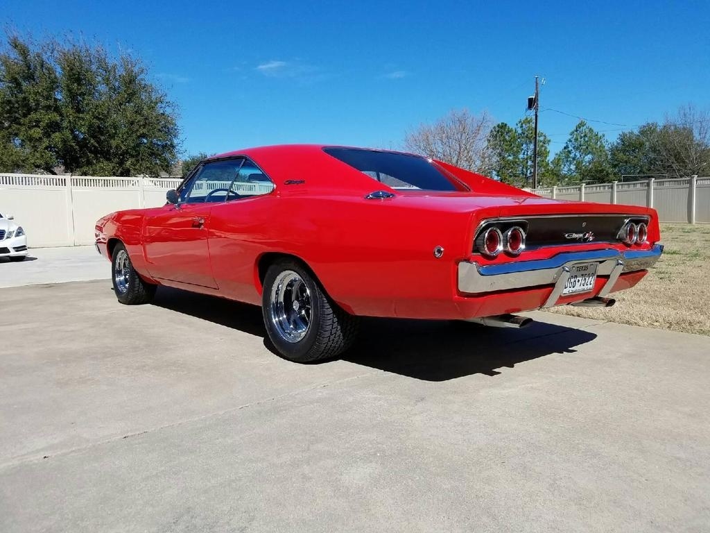

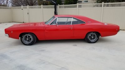

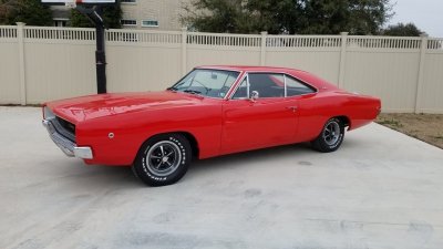

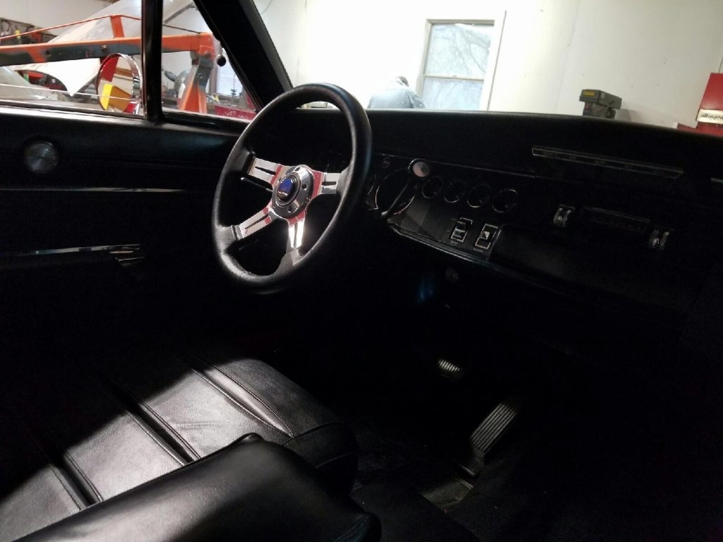

I got a 68 Charger a couple of months ago. It started life as a 318 and now has a 360. I am gradually customizing/improving it while generally staying relatively period correct. I figured I would create a build thread to track all the progress.
Below is how it came to me.
20170203_112103.jpg 20170203_112116.jpg 20170203_112133.jpg 20170203_112151.jpg

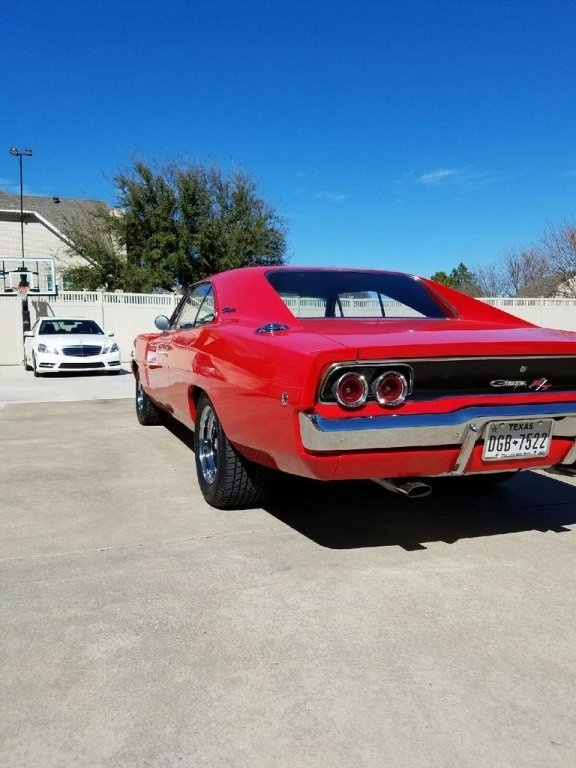

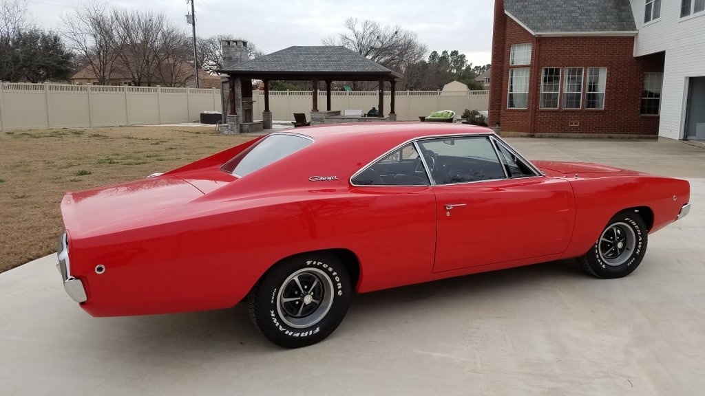

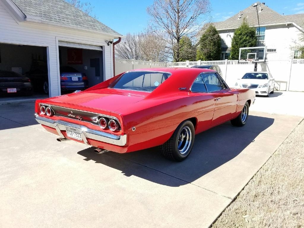

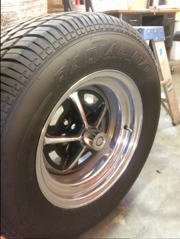

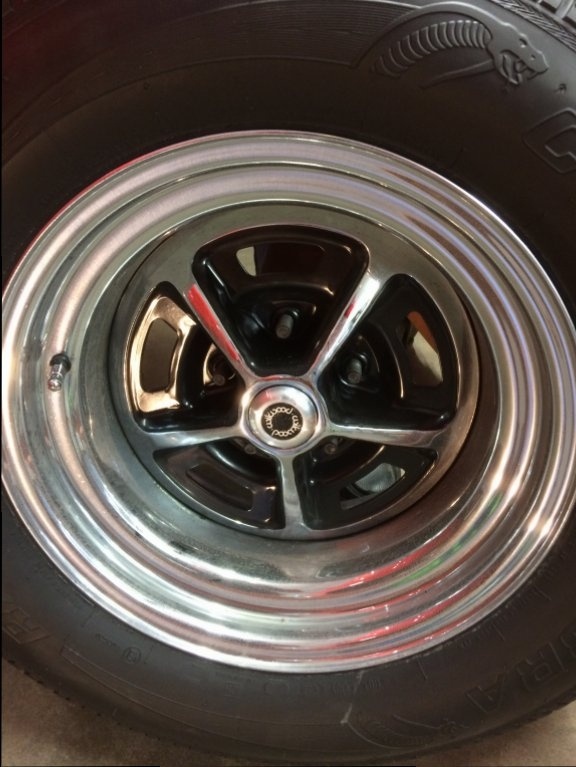

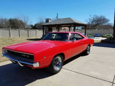

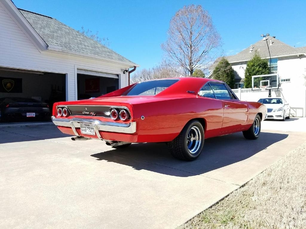

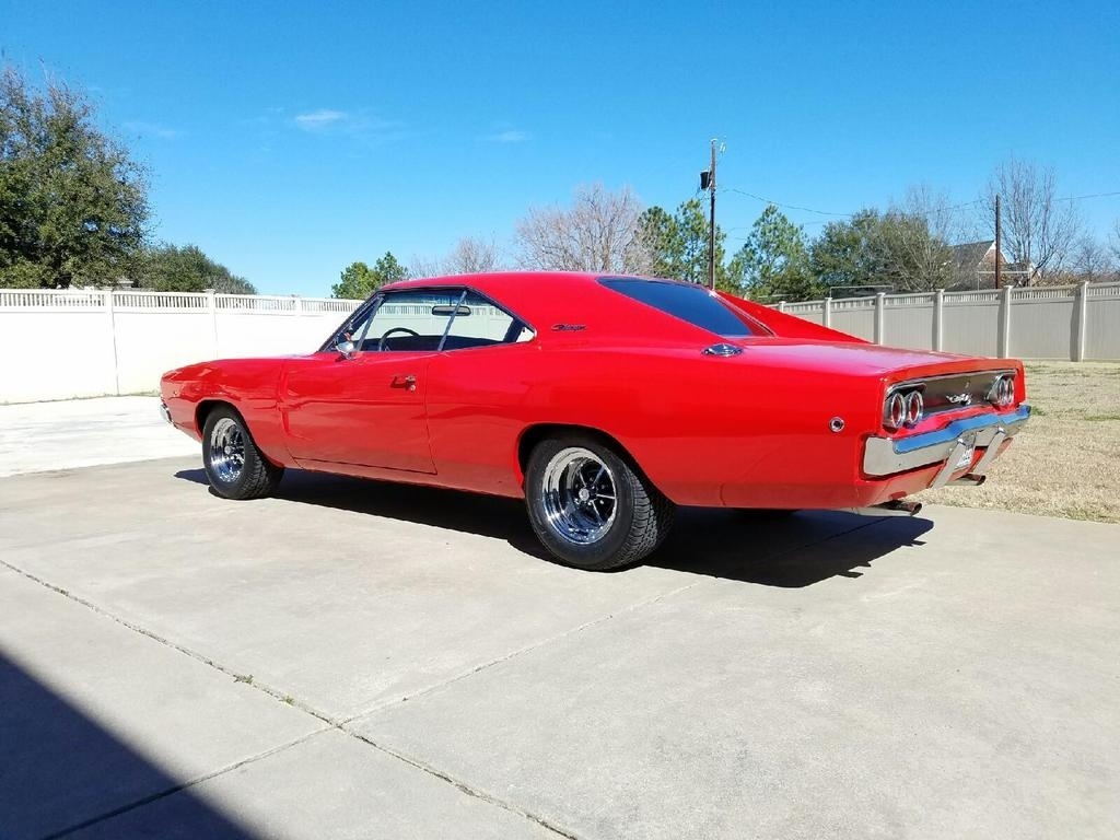

Here are the 15x8 and 15x10 Magnum 500's on 255/60/15 and 295/50/15 Coopers!
Front Quarter Upper.jpg Profile.jpg Rear Angle.jpg Rear Quarter 2.jpg Rear Quarter 3.jpg Rear Quarter Lower.jpg Rear Quarter.jpg

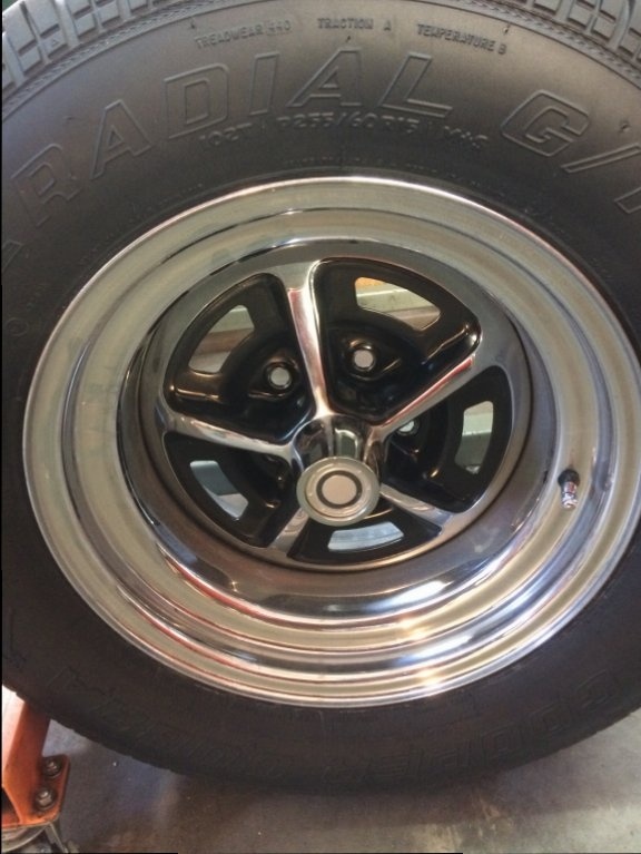

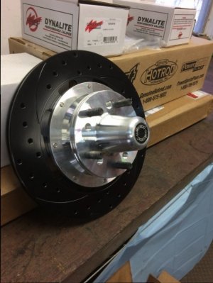

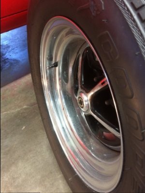

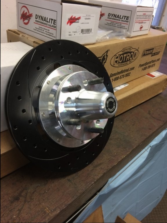

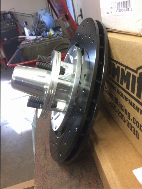

The Wilwood's would not fit with the stock Magnum 500 wheel center cap. Rather than use a spacer I've decided to just use the Wilwood hub as the centerpiece and put a Mopar center sticker. It is lower profile. Excuse the dirty wheels!
Stock Magnums
With Wilwood hub
A few goodies arrived this week:
1) Bilstein shocks
2) Front 12" Wilwood brakes, rears are on way as well. Also did proportioning valve and lines.

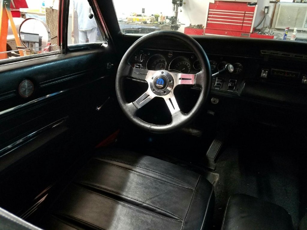

6) Grant steering wheel

The 12" Wilwood's would not in fact fit the 15" Wheels Vintique Magnum 500 (although they supposedly fit 15" wheels).
Also, since the previous owner had already done what looks like a PST front disc brake conversion I needed to order the front brakes from Magnum force since Wilwood does not make a set for disc spindle only drum. Magnum force uses Wilwood parts but mfg's their own brackets which will fit on disc spindles of varying vintages. Will post when they are mounted.
Man I tried to tell you the brakes don't clear even tho they claim to
You told me after the Wilwood's were already here. The real reason we ordered new ones is the spindle issue. We decided to also move down to 11" since it looked too close to risk doing all the work on a 12 for it not to fit!
See my issue was with just the caliper and to be entirely honest here I could have probably ground on it but the move to 17 inch wheels was on the horizon. I like the cars to appear stock but they don't have to be exactly stock you know?
