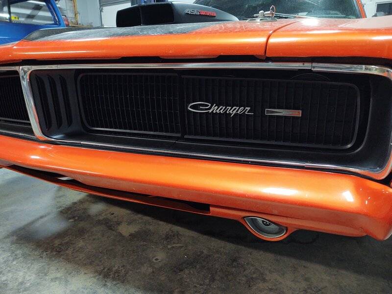

Here's the one I used plastic weld (epoxy) on, it was pretty bad.
