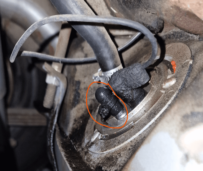

Hello,
I just bought 68 Dodge Charger and noticed a leak under a car and saw that the return line is leaking any idea with what to " seal " it again or should I just tighten the screw ?
Thank you,
Leon
Vacuum caps are not compatible with fuel, mine did the same thing so I capped it with a piece of fuel line, a 1/4” bolt and a couple of hose clamps. It hasn’t leaked since…
Or do they make a sending unit without the return line? I’m just curious because I’m gonna need to replace mine soon.
It appears to me that the rubber cap has a large crack in it with a ty wrap, not a screw. On another note, someone has been tinkering with that one before. That send unit has a 3/8 fuel outlet port with a 1/4" return port. If your car doesn't have the 1/4" return line, it would have came with a 5/16" outlet port and no return port. If your gauge is reading ok, I would do something like Black Sheep mentioned. If it needs replacing, just get one with a 5/16" port.
