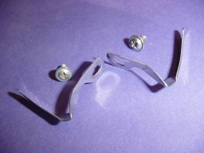

After a second look, these might be the sharp angled corner trim at the bottom.
Rather than being a bracket. Am I on the right track? Thanks again
They slide in to the bottom molding on both sides and get screwed into the door jam I guess you could say moulding braces
I have these but would have to have a picture of exactly were these go by your description ( bottom molding of what ). I have not installed them yet.
Last piece

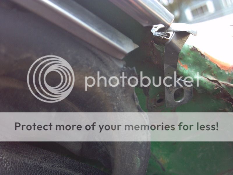

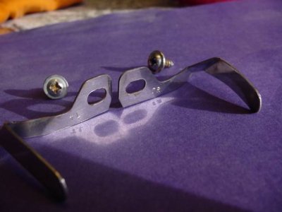

These keep the outer ends or "wings" from sticking up on your front lower mldgs. These are the last pieces to be installed on your front windshield lower trim. Once your lower mouldings are snapped into place, look at these two small pieces for an "TL" & a "TR" stamped in them. Now placing the parts on the proper sides ,you slide the flat part of these into the underside ,end of the lower mouldings. Slide them in until the hole part end of these rests against the pillar. You will have to pull the weatherstrip back up a little to put the fastening screw in place. Do not use over sized screws, these are very small screws. Then you apply a small amount of Super Waether Strip Adhesive over and around the screw & replace the weatherstrip over it & hold it against the pillar until the glue sets. :blob1: Hope this was some help.

I HAVE HAD THESE BRACKETS KICKING AROUND FOR YEARS. Your not going to believe this but I have been talking about these moldings winging out for months with my dad and what can I do about it. NOW YOU GUYS HAVE HELPED ME OUT. THANKS SO MUCH.

I screwed up and flattened down these ends so they would lay flat and now these wont fit. NOW I GOT TO REMOVE THAT MOLDING. SON OF A #%$^*. I JUST SENT DFARMERCSE A EMAIL ON HOW MANY CLIPS ARE THERE ALONG THE FRONT OF THIS TRIM. IT IS ALWAYS SOMETHING. I HOPE I DONT SCRATCH THE CAR NOW TAKING THE TRIM OFF.

I think dfarmercse will need these because after talking to him I dont think he has them and I found mine but am going to have to remove my molding now because I smashed the ends down not knowing these slid in there.. Thanks.
