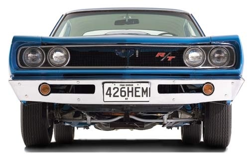

Hi there,
have you been in contact with Ian Kenyon who owns the '68 Dodge Coronet HEMI ?
He may be still connected with Matamata Panelworks.....
http://panelworks.co.nz/news-articles/68-dodge-coronet-rt/
