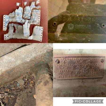

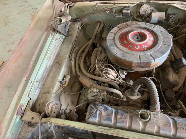

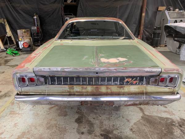

That's a late '67 air cleaner. It would be interesting to see the build date.
Saw that too, Oct 24th SPD so kinda late to have that air cleaner... Still a pretty complete 68 R/T...

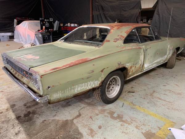

I agree and the bottoms of the rocker is rotted out also... I have a feeling a closer inspection will show that everything needs replaced but looks good in a photo...rear frame rails are gone, as is the torsion member

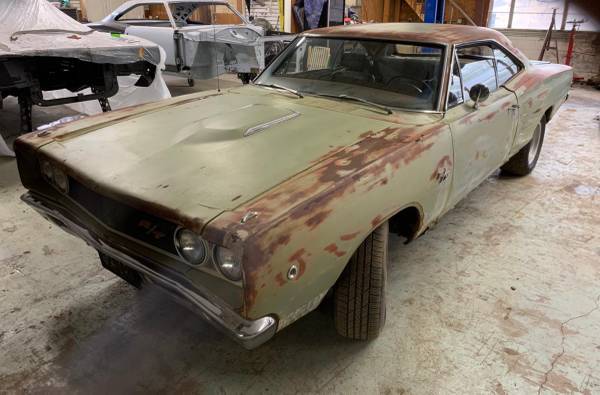

Cool model but..."some rust repair"?...uh-huh okay. 15K I'm gonna go throw up now.
Roughly what would you be looking at, parts and labor, to restore that R/T?I've stitched a bunch of these together, some rougher than others; but have yet to replace any rear rails (with the exception of collision damage)........ or outer rockers for that matter (maybe a patch where the quarter wraps over).....those aren't the problem areas
that thing is a "next level" rot box........ fixable, but you're under water the minute you bring it home, even if picked up for cheap
weld what you can to a donor body and call it a day![]()
4 dr rails & pans are the same...
