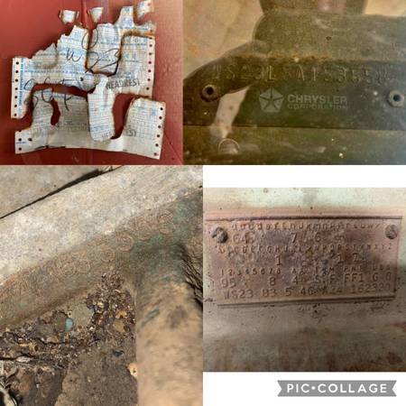

68 coronet rt not mine

That's a late '67 air cleaner. It would be interesting to see the build date.
Lynch Rd oct 24........ same plant and day as my GTX..... hmmmmmm

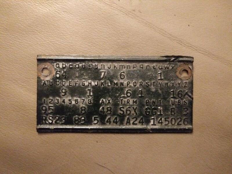

It is remarkably unmolested for a true muscle car. And it got a wicked amount of rust. Wouldn’t surprise me if it’s a one or two owner car.
