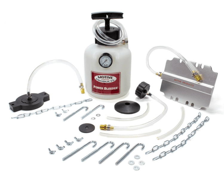

I have had real good luck with this. No bench bleed or wife needed (for the brakes :))
