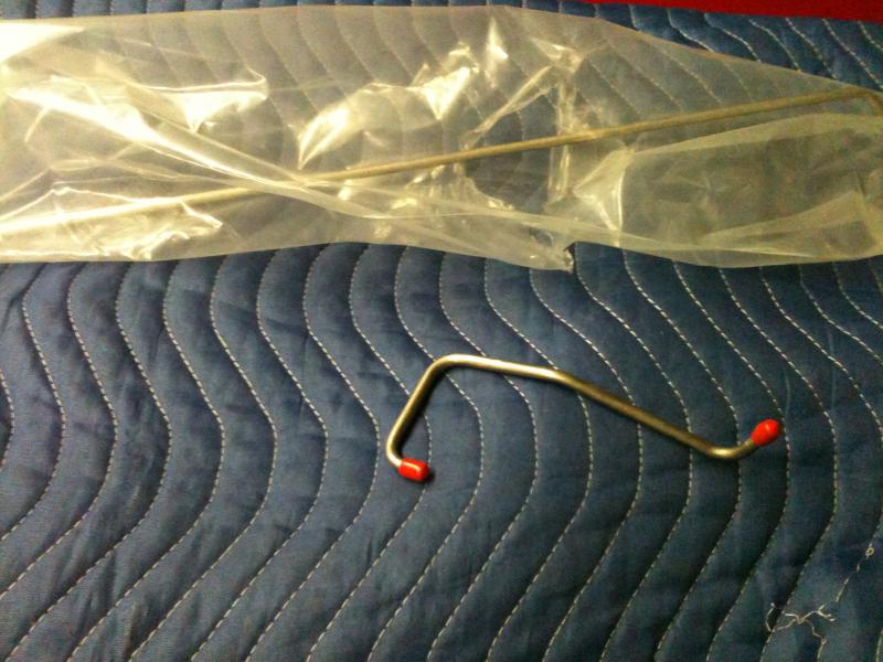

my car had a home made fuel tank vent , i ordederd one from year one, two lines showed up , the long one goes up through the trunk floor and acrros the trunk and into the frame rail, but it also came with a short one.. i have no idea where it goes, can anyone help? i attached a photo of the short one... IMG_0531[1].jpg
If memory serves me correctly,that short vent line attaches to the fuel tank on the vent outlet beside the one for the longer through the trunk floor one.There should be two outlets on the front of your fuel tank on the driver side.
It can only go on one way if you attach the mounting clip correctly, which holds it to the cross brace. I think my 69 senders have a vent tube on either side of the main line.
It just clips to the long one and vents as it is.One end to the tank and nothing to the other end
so it goes on the nipple next two the long one? wont fuel come out of it because its so short?

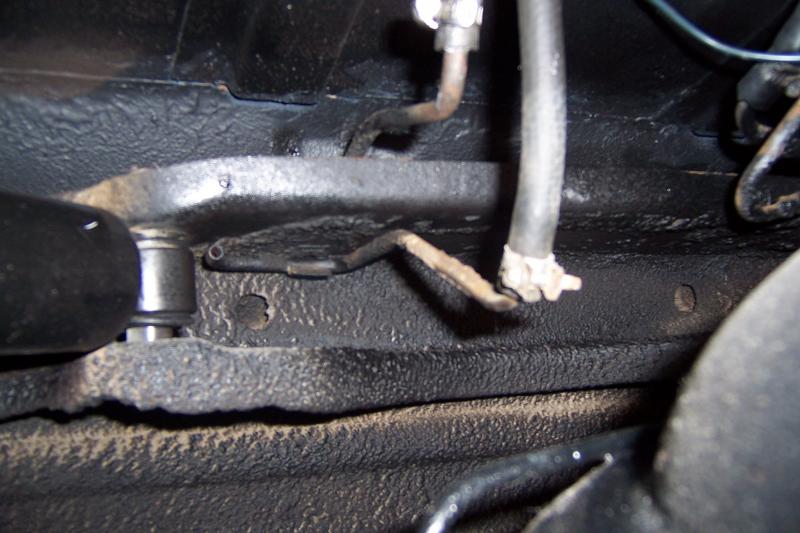

The 68 book only shows a side view but this pic was in there. Hope it helps. The short line is next to the long one on top of this tank. My tank is the one on top but once again they dont show a goo pic. of that vent. If your looking from the back of the car it is the line on the right. You can see how it goes up and clips in and comes down ( the short line ).

thanks for the pic, last question, which nipple should the long and short one goe to? i got the long one on the nipple closst to the drivers wheel and the short to the one closest to the center of the car
You are correct. The book shows the long one on the one closest to the driver wheel and the short one on the right ( closest to the center of the car ) just like the picture shows looking from the back of the tank.
