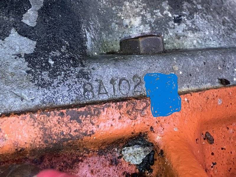

In 1968 the numbers are stamped on the back of the engine and transmission bell housing where the meet together on the top,behind the intake manifold where the oil pressure sending unit is.

This is a picture of where they are stamped. They would match the last 8 digits of the VIN number. The pictures has the last three digits covered by a blue square, this was done by the owner of the car,like you covered the numbers on your VIN tag photo.

The transmission should have the numbers stamped on the passenger's side of the case on a rectangular shaped raised pad.
At some point during the '68 prodction run, if not the full year, they started stamping the last half of the VIN on the pad on the transmission. Hamtramk cars for sure. I have an '68 18 spline trans with a Hamtramk VIN. The engine code does not show, so I am not sure if it is from 426 or 440 car though.
If I’m not mistaken, they didn’t start stamping vins on blocks until 69.

Look at the rear of the block where the transmission bolts up - I've had/have serial #'s on both of these -the block and trans stamped together for 1968....maybe because they were special built and not a regular production car....
HP engines were stamped only, my early build 68 build vert is a 2bbl 383, it’s not VIN stamped on the flange or bell. It has build day , plant etc on the ear near the starter and my car was built early August of 67.
The VIN stamp I showed is from a 68 Hemi Coronet R/T,and the Lynch Road serial number 102XXX is very early in the 68 model year,perhaps Augst of 67.
I've never seen a 68 model year Hemi without a VIN stamp.... Hemi's were special & got treated differently.....
I have seen a few early 68 model year 440's built in 67 without a stamped VIN.... But I've also seen early 68's built in 67 that were stamped...
I've seen plenty of 383's from mid year 68 that weren't stamped... It honestly wouldn't surprise me to see a mid year 440 without a stamp...
