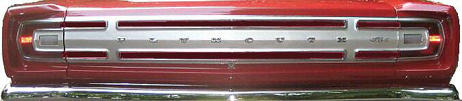

Not quite. The GTX shares taillight finishes with the Sport Satellites - but not the RoadRunners, Belvederes, etc.
1968 GTX/Sport Satellite taillights:
Notice the argent silver band around the reverse lights, for example.

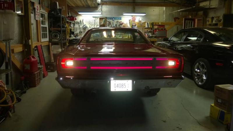

1968 Road Runner tails:
Notice the black around the reverse lights and the totally different trunk finish panel.
The sheetmetal for all the b-body Plymouths in the rear are the same, but the tail lights and finish panels are quite different.

The two pics of the GTX tails I posted are actually of my car. I had my finish panel and taillights professionally redone,
because reproduction ones will easily run over $1000.
