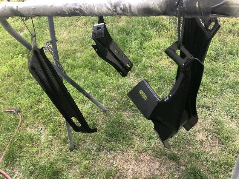

Front bumper brackets were sitting in the dip tank for about a month and still needed a light spot blast. The metal was torn in a couple spots and I welded it up. Spi epoxy, summit single stage black. Glad to do that job on a nice day outdoors and keep overspray away from the gtx.
I admit I did make a mistake and get a tiny bit of overspray on the car previously which a clay bar took care of,100%. The trouble was, most clay bar lubes have wax in them, and I’m dedicated to not waxing this car for a long time. Long story short, Wizards Mist and Shine is the only product I could find with zero wax and did what I needed.
Though I’ve used a lot of the summit single stage product as a chassis black and for steel wheels and stuff, I’m still learning it. It was over 80F yesterday so I decided to add a slow reducer (4:1:1 mix instead of 4:1). It laid down better than ever/was a good experiment to try, and I’ll stick with that. It was the second time reducing it (first time was on the rear underbody, but I used around 10% and that worked well too) so I feel I learned more about it and proved out my process well enough.

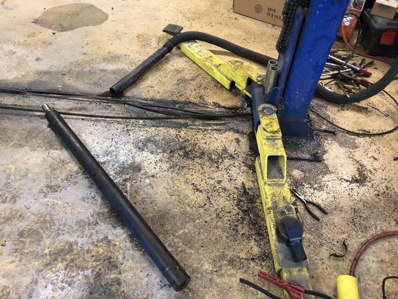

With the car out of the shop for a minute and no fear of damage, I was then able to tear into the hoist.
That leaking cylinder has driven me crazy for a couple years and it was good to get that rascal
out of there. I'll probably just drop it off somewhere and have a pro go through it + my equalizer cable
is starting to look ratty so I'll shop for a new one of those too.
Just so nobody gets the wrong idea, this is an OLD hoist.
It's a 9000lb capacity bend pak and probably from the 80s (maybe 90s).
It's so darn old, it even says "made in usa" on it.
Brand new today, the equivalent would probably be about 5 grand.
It had been used in a pro environment for who knows how long,
I bought it second hand for $1200, and have probably done at least $30k worth of work using it, so I feel like
it owes me nothing.
