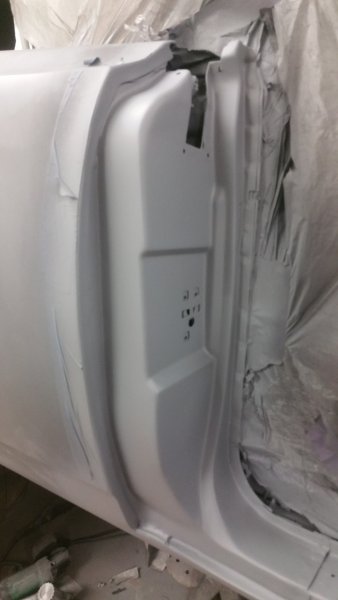

My plan was to get the whole tub sanded to 220 and with couple coats of surfacer on top of that for final prep,
Refine the jambs out to 600, shoot the jambs, and then evaluate for the next steps.

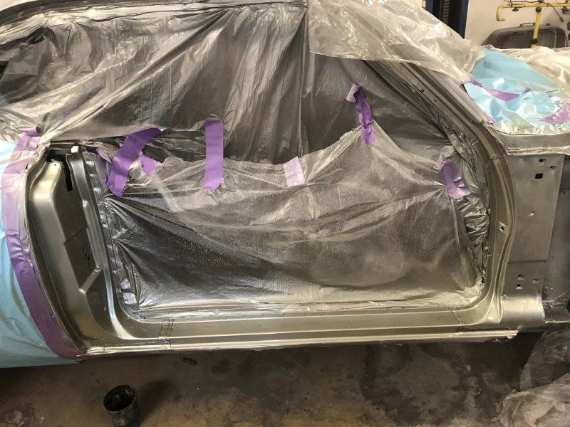

Soft masking is an art unto itself and I learned some ground floor, super basic things about it here on the jambs.
Getting the jambs into base/clear was another huge bump. Having something shiny to look at after a couple years of effort

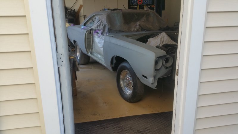

After that, repositioned the car for final prep. Although I am not sure it's necessary anymore with modern materials, I decided I wanted the ability to "walk the car" (really:the sides) for orientation coat. This being only my second metallic job and only third ever paint job, All the work towards making it possible to "walk the car" is really towards avoiding the failure mode where the metallics aren't laying quite right.
Turned the car to allow that. Decided this would definitely be preferable to having the hoist in the way during the process.
It does make it much easier to get around it, everywhere except the lower body
(It was alot more enjoyable doing bodywork on the lower areas, standing up with the car in the air) ....

(then the jambs were refined and painted)

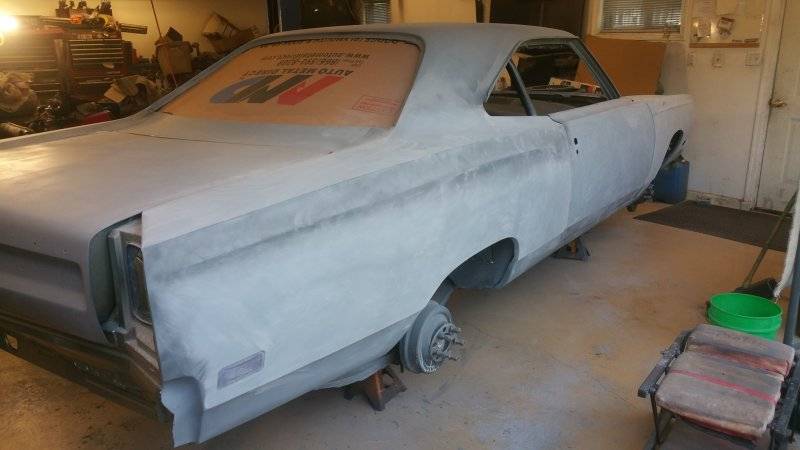

Block the entire shell to 320
That's where the project sits in these shots.
@320 I found a couple problem areas to address, but overall it was looking pretty good.
Some of the work in the jambs. I'm pretty happy with how the rust repair in the right jamb came out, but at the time I did it...it seemed like second nature because I'd do so many bigger repairs prior to it.

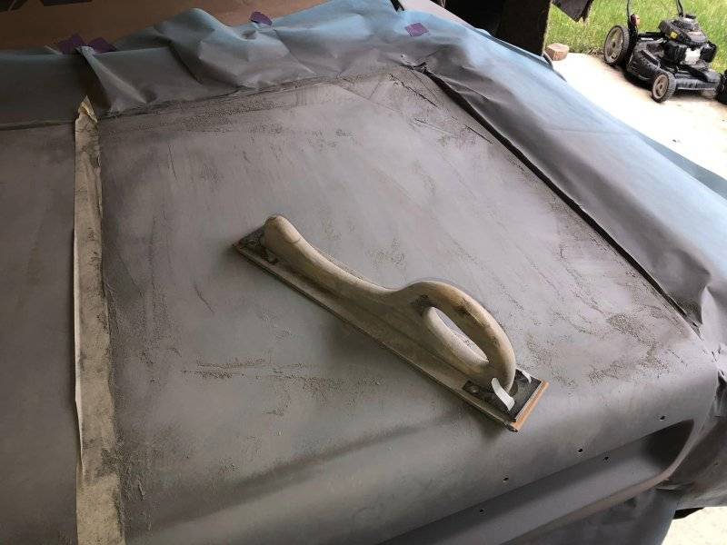

Hand blocked in 320 dry. Some areas needed it 2 or 3 times to be right.
Previous areas were blocked to 220 and had 2 additional coats of surfacer applied to give enough material to work with.
After that, blocked with 400 wet. Wet check revealed a high spot on the trunk lid that needed to be repaired.
Addressed that (you can see the lighter colored epoxy in that area), and blocked to 400 wet again in the areas that needed it.
Then blocked 600 wet.
The car was really looking great at this point.

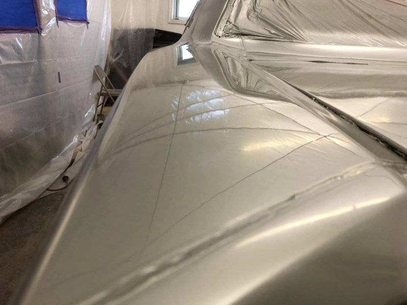

Decided to go one more step to help ensure metallics could not lay in a directional sand scratch,
so I refined the whole thing to 600 dry on an interface pad.
It gave me the surface I was looking for.
There was just enough difference between wet and dry, hand and machine, directional and random to do what I wanted.

I pulled no punches sanding the car, EVER, but especially at this point: this is the last chance to get it right.
As a result there are enough cut throughs to bare metal, one good sized gray epoxy repair on the trunk, and cut throughs to
older epoxy (the black areas) that I want to seal with reduced epoxy per the SPI "perfect paint job" instructions, thankfully I'd planned slightly ahead and ordered gray epoxy for the end game.

On the GTX, several areas in the jambs that are pictured were also surfacer that
was sanded through to metal in spots, then epoxy/base/clear.

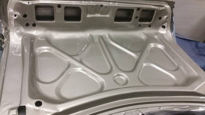

What's happening here are a few issues. The cover was not painted in the installed position. The covers can also get painted in a different booth that the main car. And being plastic, it has a different drying rate compared to metal. Add on to that, if the paint is not getting sucked out of the same container, it will be different. Yes you can get it made to a formula but there are always differences in the make up. There can be a bump of too much of a given toner which will change things. The toner mix can be off. If you get your material in multiple containers, for the base, dump it in one big one. Mix it up well and put it back into the smaller containers. This will help ensure any variances in the batch don't show up.
Very productive working day today. I can't describe all the little things that were done but highlights are......Hooked up additional lighting, cleaned the "booth" out, Wiped with water/alcohol based wax and grease remover, wiped with solvent wax and grease remover, tacked off and Laid down a coat of reduced epoxy. I don't see any sand scratches so that is a big relief.
Tomorrow: seam sealer and basecoat.

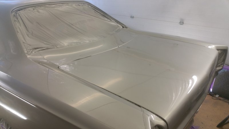

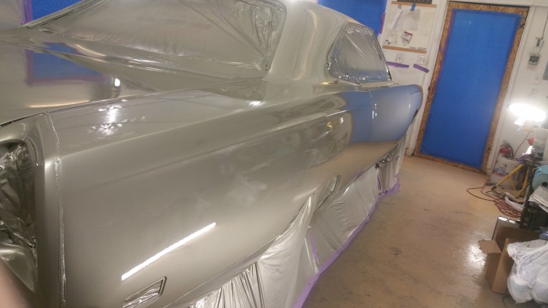

July 5th.....Woke on my own at 2:30am, thought "ridiculous, and that's what I get for going to bed too early.
Whoa there....It's clear coat day. Hit it."

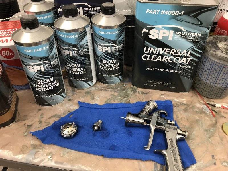

I took my time getting ready with a small meal etc, I definitely took a few minutes to get psyched up for the job, and was out in the home shop at 4:00am. It was already ridiculously humid.

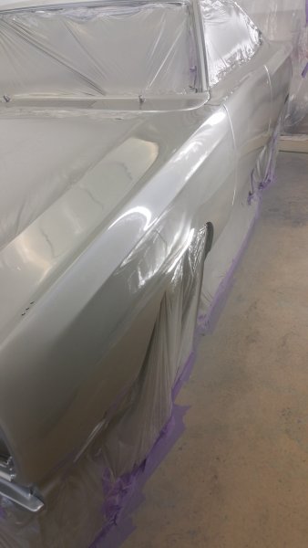

After the base, clearcoat was much more fun with only a few exceptions.
Remember the old C body Polara? Remember my philosophy "every vehicle is a test vehicle, every day is a school day?"
It does not show up in the old pictures, but My #1 biggest error on the Polara was being in a rush and taking instructions too literally. Not only did I wait the minimum time between base and clear, but because of the "spray it how you want it to look" instructions given, I laid the first coat of clear down way too wet, ran it, and "pulled" the metallics out of position. This was a major disappointment 17 years ago.
I was determined not to repeat that error on the GTX and the new strategy was successful. I laid the first coat down a little on the dry side to lock down the metallics. The second coat went on very wet and the car looked fantastic at that point.
I really could have stopped there/production is 2 coats and works fine, but......this isn't production.
All along I had planned on adding plenty of extra material to work with for correction.
Initial plan was 3 coats, then decide whether to either flow coat later, or lay down more material.
After the third coat I decided I did not want to flow coat, and decided I would lay on more material and work with that instead.
Not surprisingly the more coats I added, the more errors and insects stacked up on me.
Insects were picked out with tweezers midstream during and after every coat, but I couldn't get them all, there are a couple that will be embedded there, or be sanded out later. On the fourth coat I created a few runs and sags. I'd previously deliberately ran it on test panels and knew how easy the product was to work with, so it was really not a worry and I didn't care too much as long as the metallics were still locked down, which they were.. I went over those areas with a little extra material to sand off later/ "repair coat" so to speak, and gave a short flash time. Near the end of the 5th coat I found one group of ugly drips low on the body that was still moving, I sat there and added a little material at a time until it ran completely off the panel on to the floor masking.....now it looks like glass, except for a small, easier to work with sag.
I neither demanded nor achieved perfection, but I did exceed the target of "really good".

NGL: The car is stunning!
If it was someone else's project, I would be super impressed.
The color alone has more class than I do LOL.
The more chrome, stainless, and black is added to it, the more amazing it's gonna look.
It's going to take some effort to get there but we will make it. I'm stoked!
A4 silver is not an easy color to spray, especially in high humidity.......It really takes a ton of skill to make it look right....but when you do, it looks incredible.
