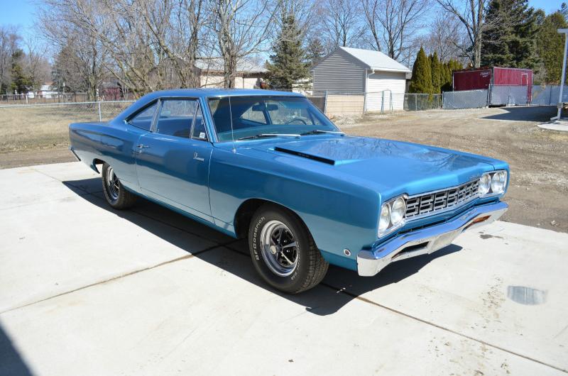

I just bought my first Mopar, a 1968 Road Runner, and it looks like it needs a new carb. I want to stick with the Carter 4bbl. Any suggestions regarding where to buy it? I've found several suppliers, including Rock Auto and Classic Industries.
Also, what does AVS or AFB mean?
I am planning on buying a carb. Is there any reason to keep the old core? Are there numbers that tie the original carb to the car? I'd like to be as original as possible, and would have the old carb rebuilt if it is meaningful.
Thanks in advance!
Jay
