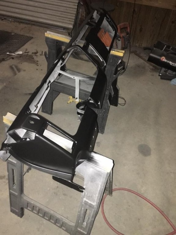

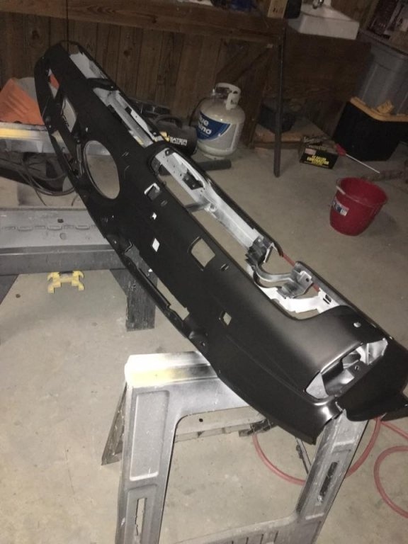

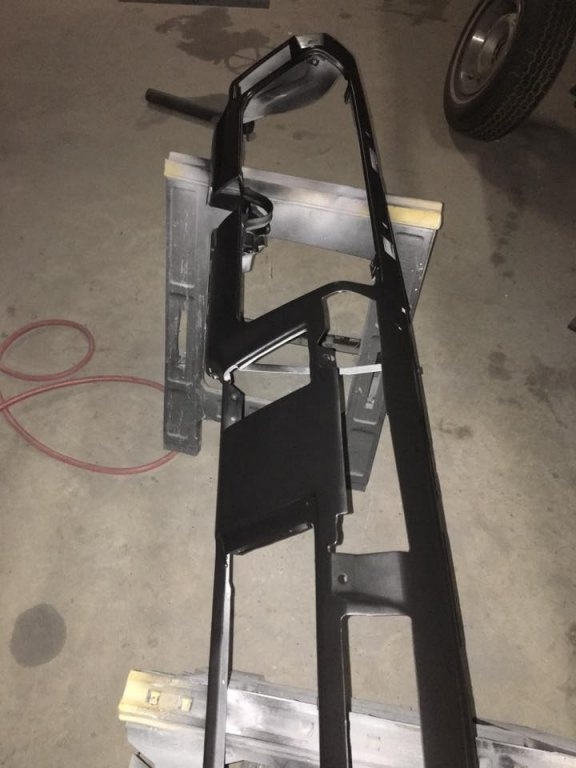

I used SEM Trim Black for my TX9 71 GTX. It was a flat to mild satin finish and it lays down real nice even out of a can. You can spray it from a gun or rattle can. I had my frame blasted and powder coated with an epoxy powder coat, then I filled a few areas of pitting with Metal-2-Metal, sanded, High Build Primer fill, then sanded a ton more, then sprayed a primer sealer, before final sand. The SEM stuff made a novice like me look good :)
View attachment 366470 View attachment 366471 View attachment 366472
real nice job. Can you tell me the part # on the can and where U bought it? SEM does have a site.
