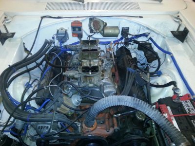

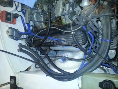

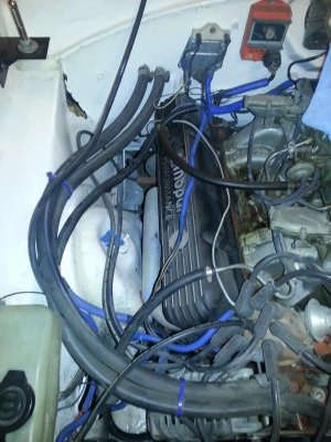

Do you have a picture of your engine bay with the 440? I am thinking of swapping my 383 for the 440 in my 68 RR..

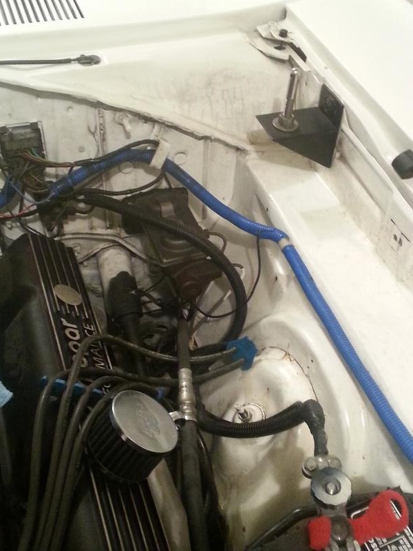

Left bank, right bank, center. Air cleaner is off as I just cleaned them and need to replace the throttle body gaskets. As you can see, it's a tight fit. I hate the wire covers. They were not my choice and will get replace eventually. It's a 440 6-pack so I have the lift off hood. The hinges were removed.
