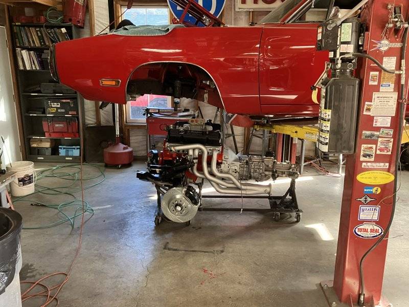

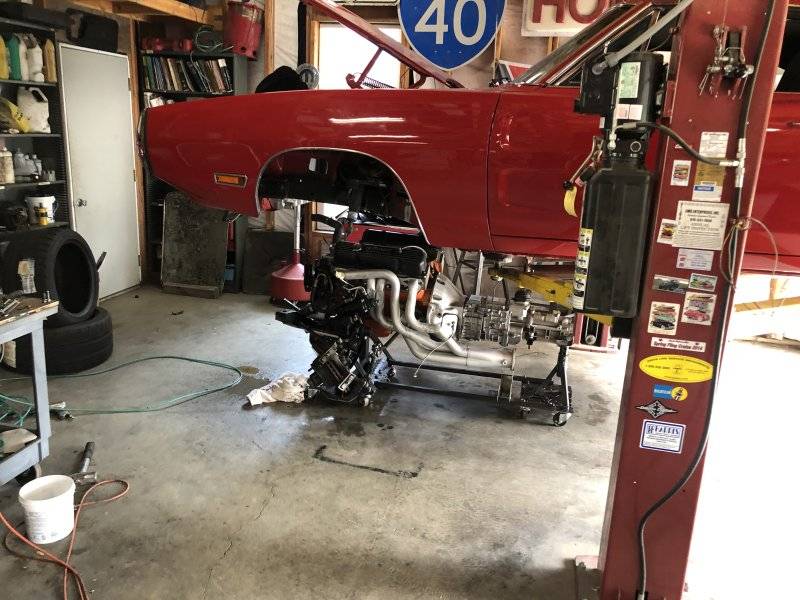

I am going to say no you can't pull the motor or refresh it with the headers on. Yeah it sucks getting starter and headers in. It can require a hammer and die grinder, at the least.
Engine out, then engine back in.

Nice to have a lift!
no lift required.......engine hoist picks up the front of the car
unload and remove the torsion bars, pop the upper ball joints, and you're 3/4 of the way there

Evidently you can do it on these cars. Tube frame and no torsion bars.
Also 426 Hemi exhaust ports point down, not out to the sides like the other mopar V8's.
Stare at these for a while and see all there is to see.
How the hemi ports face is insignificant. Installation or removal is no easier. A fully assembled engine - hemi, RB or otherwise - had to be narrow enough to fit between the frame rails and shock towers for assembly on the line. If you check, you will find that an assembled hemi is pretty damn close to the same width as a big block.
When removing the 440 with Hookers Long headers a couple months ago on a 70 RR, it was removed from on top. I had to unbolt the headers and suspend them with bungees before removing the engine. I tried all different ways, but Hookers suck. Someone said that TTI headers are easier to install and remove the engine. Can someone confirm that. When I put the engine back in, it is coming in from the bottom.
What zyzzyx did seems to be the easiest way. Nice pics.
When you put the engine back in, please post some pics.
