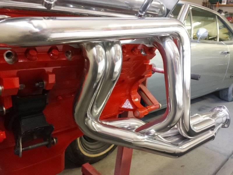

There's good and not so good headers - results vary wildly according to what brand one buys, of course.
Some seal and install well - others don't.
Some designs will cook anything and everything around them; others, not so much.
Some make plug changes a living hell; others, less so.
Some free up significant gains in performance; some, not worth the money in that regard.
Depends on what you want - and how much you wanna spend in the end.
Fred's got Hedman's "big tubes" on him; he came with them and don't you know, they refuse to rot out. :)
Not the best choice what with the PITA plug changes, excessive heat in the cabin and what not...
One thing is for certain, though - if I were building another one for semi-mild street use, manifolds would be
on that rascal in a NY minute.

Guess I'm an exception then - I'm no spring chicken and certainly not as spry at getting on the floor under
the car these days admittedly thanks to all manner of surgeries and such, yet.... there's those ridiculous
headers, still on Fred.
As many times as I've had the car apart over the years, changing to manifolds would have actually been
easier at times than wrestling the PITA Hedmans back on the car - yet I chose to, every time.
Why? The entire exhaust system doesn't rot, more than anything else.
I've never been a parts collector - if a part is on the car and performing satisfactorily, it stays, that simple.
