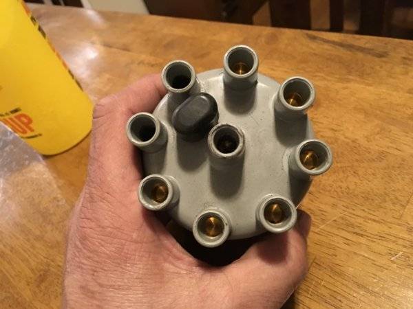

Just installed a new cap and rotor ( wires are basically brand new ) and still no spark. Here is the like new old cap, notice the 8, 4 and coil ports are all discolored instead of shiny brass like the others? All wires were inserted fully and snug, what would have caused this?

That resembles an arching situation in those terminals.. As if those two weren't seated all the way in. That would be my guess.
