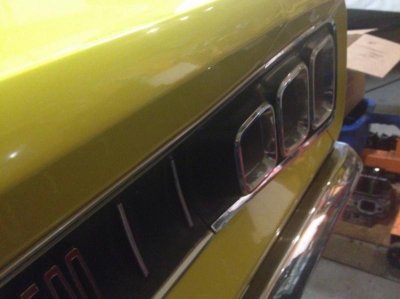

Hmmm...Don't know too much about the Non-R/T,500 trim layout back there, but on my 500 the tail light buckets transcend down and extend to a flat level to meet the finish panel. Without the panel there, it may look a bit screwy.
Maybe a pic would help:
Thanks Propwash, Looks like the decklip trim will match up ok. I'd probably have to butcher the lower piece and then I'd still be left with a noticeable step between the tail lights and the center section...
Probably just have to wait I guess.
I did a bit of google snooping. The 500/RT bevel looks like it would bolt up to the NON 500/RT light buckets. The lenses also look very similar. I might just punt on a new set of bevels, seeing as my lights are other wise in good nick. But I think I'll wait until I can get my hands on a center panel first.
