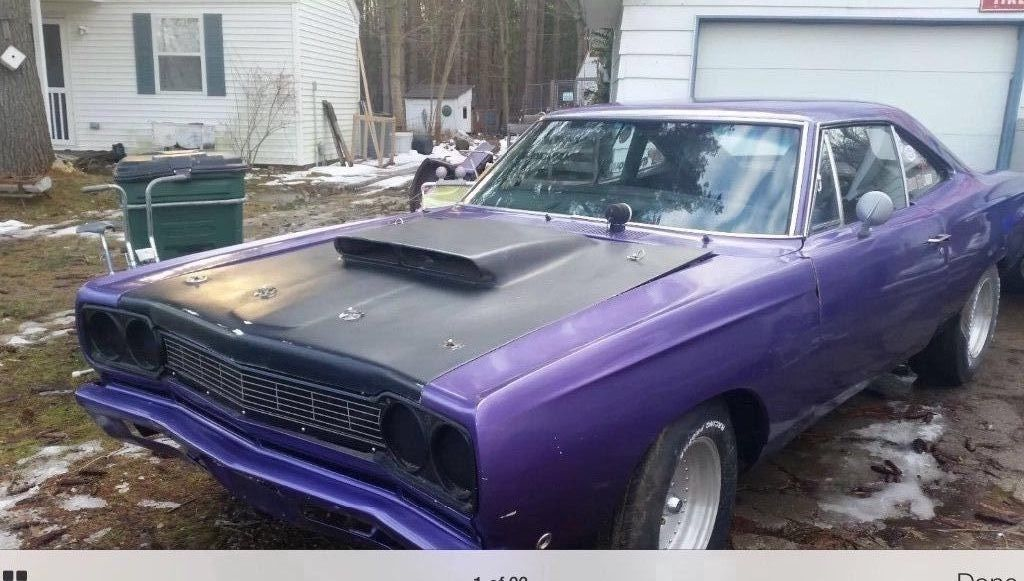

Here is a drag car that I picked off E-bay last month. The neighbors find the noise and smell offensive. I'm slowly learning what is involved with the restoration of this beast. The parts from '68 can be added to the '67 Charger to make a better restoration. This Satellite is set up as a street / super stock car. Body work is extensive, but mechanically the car is solid.
The only pix I have right now are from the seller.

Interesting, but what is it your doing ?
So are you taking stuff off the complete 68 Satty ?
to build a 67 Charger ?
or are you going to build/work on the 68 Satty ?
Does the 68 Satty run & drive ?
Did the former owner give you any engine specifics ?
or other information like ET's MPH etc. ?
Looks like something built in the late 80's to early 90's,
by the wheels {Enci's or Centerlines ?} & monolithic paint style...
What's in the engine, what ci etc. ?
looks like a RB {413, 426 ?} by the style of intake...
More specifics maybe, if you could share them, that is if you know...
What type rear end, what gears, what suspension mods if any ?
What type of trans & if it's a 727 what converter, shifter etc. ?
Looks like a roll-bar in it too, unless that's just a weird reflection...
It has it's possibilities, certainly could be a decent project...
That 6bbl hood looks messed up/warped, could maybe be fixed
add some understructure, cut & re-glassing, redoing the way the pins are etc.
I assume what ever your doing, it {or the 67 Charger ?} will be raced ?
What kind of expectations/outcome are you looking for ?
Hell I only got to 12 questions, I'm slipping,
that means I still have 8 in the bank...LOL
Good luck, Have fun & Happy Moparing,
that's what it's all about...

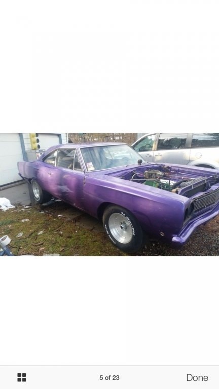

I'm building a collection of old Mopar B body cars. It's not a planned progression. I started looking for a Dart or Valiant and just fell into these machines. Since the Plymouth showed up, the dude with a Pontiac Lemans doesn't drive past my house anymore. To be simple about everything, my focus is getting the Charger started and on the road. This Plymouth Satellite is a unexpected bonus for being ethical and chivalrous. LOL
Right now with the '68 S.S. it will continue to be fixed up so we can pass tech inspection at the track. I'll drive to the track and put some Chevy and Ford's on the trailer early. When they sell all their junk, I might pick up a trailer cheap. e
The brakes are still factory 11" drum brakes. Disc brake upgrade is important for performance as well as a weight issue.
***--->> If I get starting making weight weenie upgrades, I might as well as get the fiberglass body and build a race chassis kit <---*** Curious if the driver side lugs are LH thread or the lugs have been replaced to a RH thread.
Satellite runs and drives ok, at least to the mall across the street. It had "Miss Molly" as a tribute car so I think that fits and some large turned gold flake lettering might be nice. The owner had just picked up the car in March. I haven't tried to contact the original owner from Michigan.
Engine is a RB 440 wedge.:bs_flag: don't know about the bore, stroke or compression. I opened the oil cap and it has aluminum roller rockers. #6 cylinder is burning oil. It is a high rise intake with a Holley L8896 Dominator carb. I got the 2bbl rebuild ok. Tuning the big Holley 1550 double "wino" pumper is rewarding. A carb rebuild and a 2x4bbl is my next notch on the bedpost. MSD ignition and rev limiter (or transbrake). Lime Green Taylor 8mm ignition wires. The lime green color shows hot spots and we will try to re route the spark wires to keep them cool. Big Mopar waterpump and radiator.
The coil, and some paint around the master cylinder, indicate excessive heat, possibly an old engine fire. No other evidence of fire at this point. The coil can be swapped with an Accel SuperStock unit I bought as a backup. The coil wire is also 8mm and needs replaced more than the plug wires. The cost effective solution is the whole 11mm wire package, because the coil wire alone is 1/4 of the price. Good spark, fresh plugs, not a problem.
B&M shifter works smooth. I lost some messages but I thought it has a 3000~something stall converter. That makes me curious because of the rev limiter connection also. looks like a 727 TF. 4:10 rear gears.
Roll bar is fully welded and the floor is needing to be replaced. It seems solid but the price for 2-16g flat steel panels is around $120. AMD listing for the front panels are $199. The supports are solid. My real problem is with the edges rusting in the front floor boards. Needs attention. Passenger rear panel has significant rust damage extending down into the passenger rear wheel well.
I could cut out both wheel wells and install carbon fiber tubs or try to fab some fiberglass tubs or just tack in a steel tub. That would allow a stock 14" wheel or a 15x15 wheel with a strip axle housing from the local guys QA1 or a better gear range with Strange axle and housing. I'm looking at some Bassett wheels 15x15 and 4"backset. Tires TBA.
Suspension mods come with the stock front and a ladder bar in the back. The front can be swapped to a tubular arm package but that will fall under the weight weenie category and saved for the doorslammer tube chassis version.
Competition engineering shocks on 4 cornera and I can easily replace the bushings with an Energy suspension kit. If there is a better bushing kit outside of energy suspension, I would like your feedback too. I want to sandblast the stock suspension down to bare metal and give it a coat of semi gloss clear coat.
Coilover shocks and a 4 link suspension are the next upgrade for this car.
get rid of the leaf springs and let the girl grab some traction.
The hood has a problem with the rear mounts that needed adjustment. The mounts could be moved back over the fender a little to keep the corners pinned down. There is an aluminum sheet (intake) pulling the hood down, in to centerline. The fiberglass repair is complete and could be argued whether that shroud is needed or not. I can see the benefit of a forced air hood scoop, and I'm toying with the idea of stretching some pantyhose over the scoop (as a filter).
We busted the fiberglass bumper off on the trailer wire, unloading the car. That has been repaired. I'm planning to fiberglass mold a homegrown one piece grill, starting with the headlight bezels and then a shoddy outline of the original grill. If there is a fiberglass or lexan airbursh replica of and entire original Satellite Sport grille, I'll be calling your number.

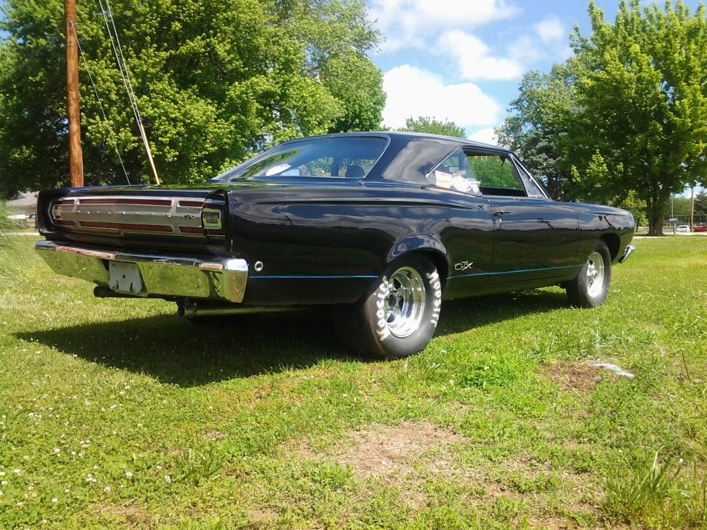

Hang in there. My car was the same way as your car.
I bought it as a drag car, then proceeded to wire it and
put exhaust on it. I also scraped all the old, cracked paint
off of it. Then painted it black.
That's a sharp looking Plymouth STREETREBEL.
