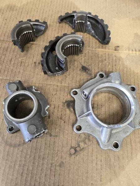

CSI Miami was on the scene when I left, probably they will have the tale shaft in custody by morning!Looks like a murder scene.
It's more like Columbo or Kojak are needed to get down to the root of the problem. Radio in for ballistics to have a sniff around the crime scene.CSI Miami was on the scene when I left, probably they will have the tale shaft in custody by morning!
Berreta showed up with a broken snap ring - and you can take that to the bank!!!It's more like Columbo or Kojak are needed to get down to the root of the problem. Radio in for ballistics to have a sniff around the crime scene.
Broken snap ring is from the governor assembly. Pull the tailshaft housing to see what happened in there. Likely FUBAR, and looks like Doug's picture. I think I can see the ball that drives the rear pump in that shrapnel.Berreta showed up with a broken snap ring - and you can take that to the bank!!!
After removing the sprag and chunks falling out, the park gear would spin freely with an ice pick. didn't get the housing removed yet, wouldn't you know of all the snap ring tools in the box, didn't have the correct one to spread the snap ring to remove the housing - it will be here Friday! Any suggestions for making this thing Bullet Proof? A&A is my first thought.I'm assumimg those parts are aluminum by the look of them. If so they are more than likely not park pawl material. Unless the park gear exploded and hit the case.

The tail shaft housing appears to be OK, a few bumps and bruises! Will be chatting with Rick on Monday...Wow, what a mess. It looks like someone shifted into PARK at 60 mph! I hope case and especially the one-year-only tailshaft housing is O.K. A&A can fix you up with replacements for your destroyed parts. They even sell reconditioned used parts at a discount. When you have trans apart, really look your sprag clutch over.
