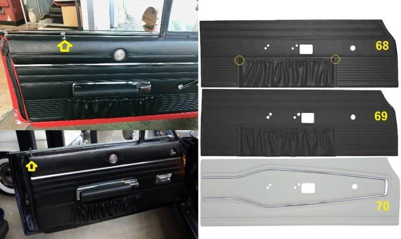

The physical difference (fit) is in the upper front door pads as far as the lock button position. The door cards would actually fit any B-body door (I believe). The '68 door cards may have a slight difference in appearance from a '69 in that the (again - I believe) earliest ones could have a silver fastener at the top corners of the map pocket - someone check me on this. The '70 door cards have a completely different appearance with no pocket - unless an "SE" which has the pocket and also some wood grain instead of the Charger "dart".
Image to peruse. (Edit: I should have notated; top door-lock pic is 69-70 position, bottom pic is 68 position)
The square chrome buttons on the corners of the 68 map pockets seem to have disappeared sometime in March 1968.
