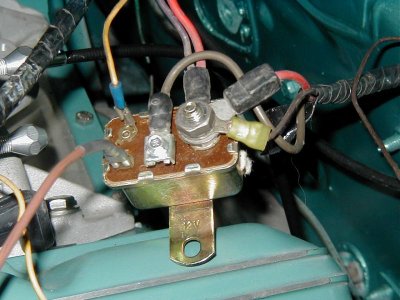

Its the light brown wire on the left of the photo. You will not have this terminal if your car has a standard transmission.

I ran a wire from the trans switch to the ground terminal and boom, the car fires up with the switch. Thanks for the help guys.
Glad I could help BUT make sure to remember that the car will now start in gear. Make up a new wire and get it connected to the transmission...please!
