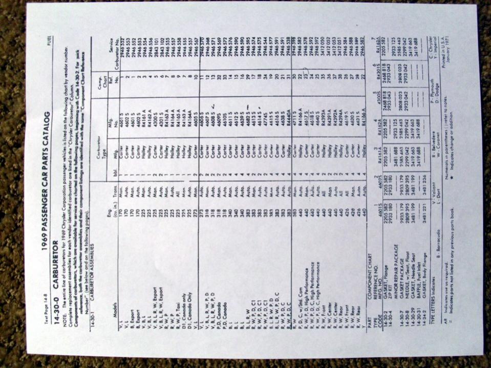

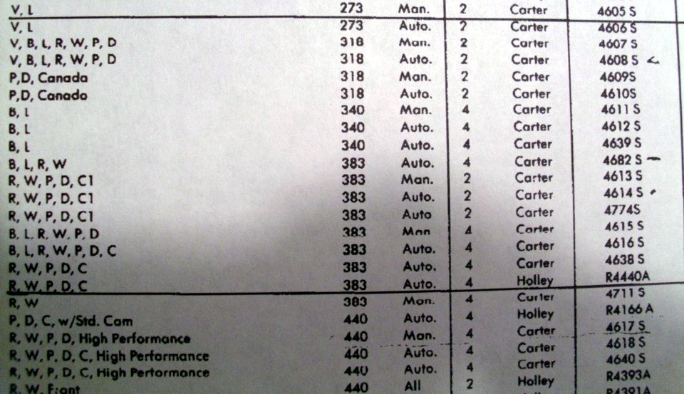

cleaning up my desk I found my 1969 parts catalog on CD rom
it seems the carb I had just put up for sale is the correct carb for my 69 rag top 383
the attached pic of the page also shows that holleys were used on 383
Now I dont know how to read the codes to the right of the parts listing so if anyone can chime in
I might be wrong but I'm assuming that the letters refer to the first didgit of the VIN
Holleys were used on 383-4bbl cars....the 330 horse version with or without A/C.
Carters were used on the 335 version.
What your chart does not do is distinguish between the 335 and 330 horse versions nor indicate A/C or not.
Yes, the letter on the left refers to the model line designation (L=Dart, R=Belevdere, W=Coronet, etc)
