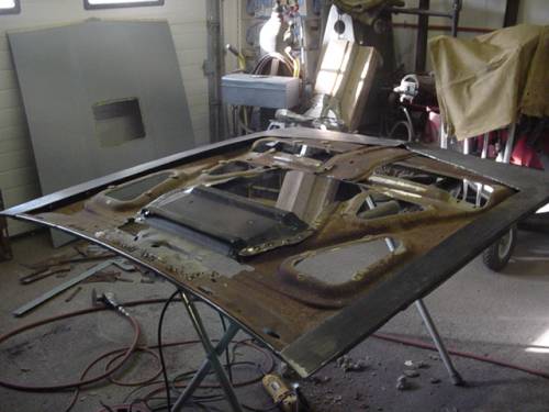

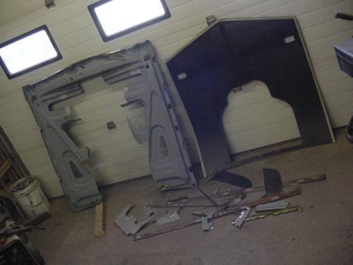

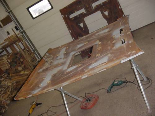

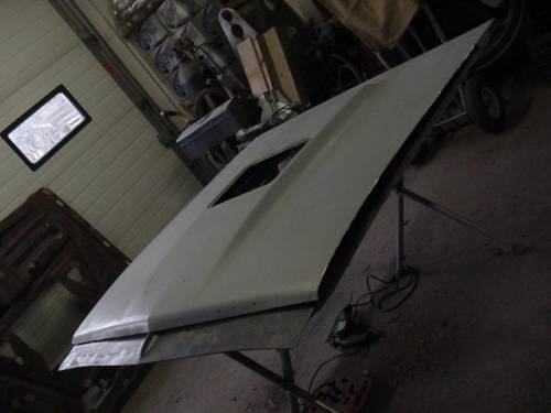

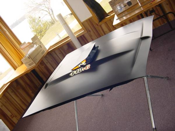

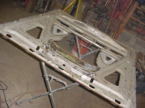

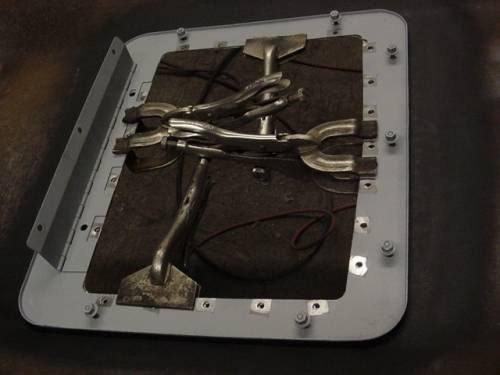

Re & Re hood ( skin )
:edgy: The only thing that would be close to the same is the contour line along the back of the hood to the cowl, as the same cowl vent panel was used from 66-70. If you wanted to keep the 69 fenders, grille, etc... then the only other way would be to skin the 70 hood and put it on a 69 frame / along with a few alterations. Similar the this 70 Road Runner skin on a 70 Charger frame. :grin:
