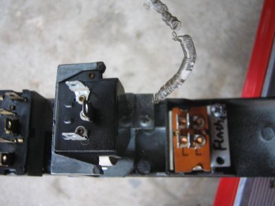

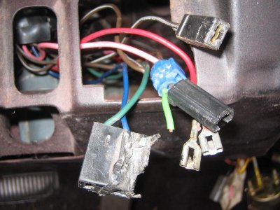

2 main problems that I can see straight away are....The stripped and broken wiper plug...and the dome light switch total shagged...

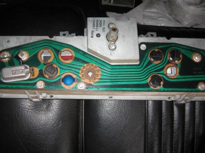

here are some pic's....like to buy these bits? if someone has some spare..
or maybe a replacement underdash harness????

Looks like you need some new stuff.
The melted connection plug usually means something is drawing too much power. I have seen it with heater fan motors and I am assuming this is the plug for your wiper motor?
I am just guessing here but I'd say there is a good chance your wiper motor needs a rebuild. I suppose it's possible too that the wiper motor became stuck and the switch was left on with the wiper motor stuck.
Either way I'd have a look at that wiper motor rather than just repairing the connector.
The scrolling wheel or "dimmer" type roller switch must be a weakness in these old mopars because the one in my 69 roadrunner is junk as well.
