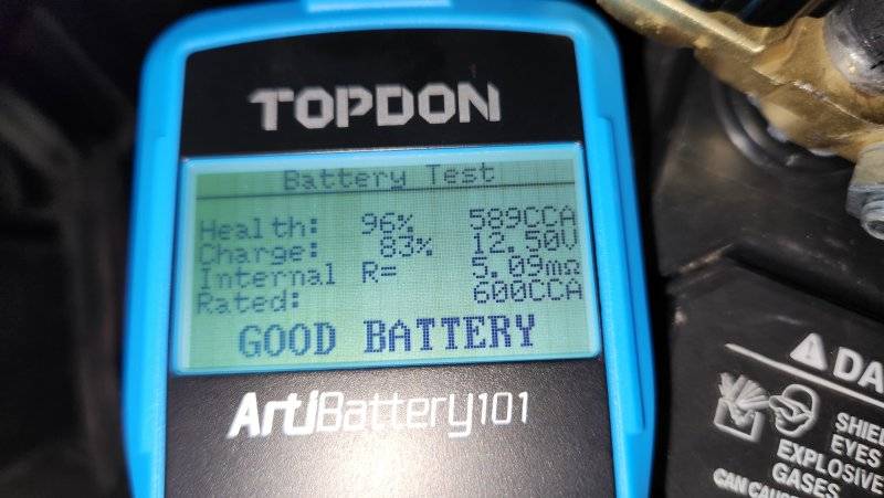

Posting screenshots and a video of my battery and alternator test.
I'm assuming the alternator is overcharging because of the way my electrical system works. I'm familiar that anything run off the battery causes the alternator to shoot more juice over to make up for it.
Is that the reason for my overcharging status?
Just want to be sure that neither of these parts are the reason for my battery dying.

Your battery is bad. It’s very typical to have a slow battery drain on 50 yr old wiring (+ clock)

Fully charge your battery, and then disconnect a battery cable. If it is dead after a week or so, then it is pooched. If it is still charged at 12.5 ish volts then you have a draw in your electrical system.
It is not your charging system. That is working fine. It don't take much of a draw to kill a battery in a couple days. I would charge it up good and put an amp meter in series with the battery plus cable and battery post to see how much of a draw you have. Even 5 milli amps will take a battery to zero in short order. If you have no current flow through your meter, your battery is junk. I had a .5A draw on my car once and it ended up being the glove box light was not shutting off.

You say no clock, stock radio. If your comment about the needle occasionally indicating slightly to discharge, and that's with car turned off, that's a clue that somethings wrong. With car off, should be no current draw on battery whatsoever, unless some accessory requires 12 V to keep alive. If you don't have one, get a
multimeter and use the current function of the meter as was suggested.
Disconnect + battery, set meter to measure DC current, put meter leads in series with the + battery lead and battery post. If you see any deflection or indication of current draw that would confirm that something is draining your battery. If yes, you need to dig deeper to find what's causing the discharge, if not... battery's likely bad.
