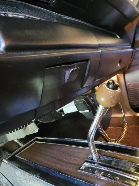

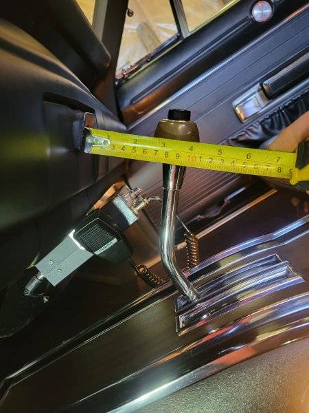

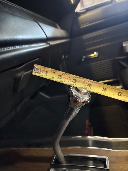

Thank you very much for the pics. Does anybody with a 69 charger have the measurement from the knob to the ashtray button when the shifter is in park? Also, from a previous installation diagram I noticed that the lever at the transmission has a bend in it versus some that are straight. This also could affect things. Does anybody know what the correct lever is at the transmission? Is it straight or does it have a dog leg?
Looks like about 2 and 5/8"
I'm getting about the exact same measurement. 69 Charger
