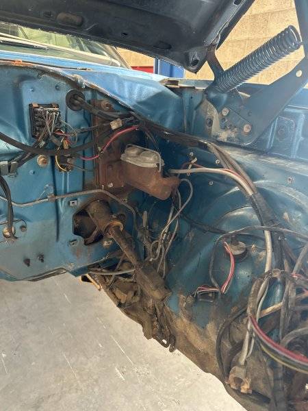

Hi friends, can you tell me the best disc conversion kit to install on my charger I’m doing the front end and motor at this time. It is non power brakes. I read a lot of different manufacturers but would much rather hear it from the experts here.
Thanks!!
Tony
