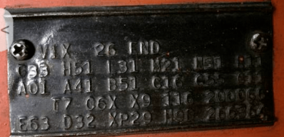

3rd - Was hemi Orange available as an exterior color in 69?

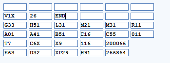

Based on the Fender Tag Did I decode it correctly?
XP29:
Dodge Charger
Premium
2 Door Sports Hardtop
H91: 383 330HP OR 335HP 1-4BBL 8 CYL
1969
Lynch Road, MI, USA
266864: Sequence number
E63: 383 cid 4 barrel V8 H.P. 335hp
D32: Heavy Duty Automatic Transmission
T7: Dark Bronze Metallic Exterior Color
C6X: Trim - Charger, Vinyl Bucket Seats, Black
X9: Black Int. Door Frames
116: Build Date: January 16
200066: Order number
A01: Unknown Top Color
A41: 69 only White Hat Special w/vinyl roof
B51: Power Brakes
C16: Console w/Woodgrain Panel
C55: Bucket Seats
011: Unknown
G33: LH Remote Racing Mirror
H51: Air Conditioning with Heater
L31: Hood/Fender Mounted Turn Signals
M21: Roof drip rail moldings
M31: Belt Moldings
R11: Radio Solid State AM (2 Watts)
V1X: Unknown
26: 26in Radiator
END: End of Sales Codes

Thanks! So VX1 = Black Vinyl Roof which was part of the White Hat Special (A41: 69 only White Hat Special w/vinyl roof)
V1X=Black vinyl top.
