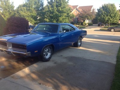

Hey everyone. Posted a few times here and there, just throwing out where I am at with planning my restoration, see what you all think. A little back story, got my 1969 charger r/t clone back when I was 16 (before I even had my license). She looked great but engine, trans, and diff were blown (some crazy stories on those). Rebuilt engine and trans, 383 out of a 71 cuda and the original 727 Torqueflite. Swapped the 3.23 gears for the Borg Warner 4.10 suregrip. Was originally a 318 car, previous owner made the r/t clone mods. I rebuilt it to stock just because I wanted to drive it in high school and because, well lets face it, I had no money after buying it. Now, Im 22 and about to graduate college, which means one great thing: the almost 20k per year I've be paying for tuition can now go towards what matters most, the resto!
So here's what I'm thinking. I want something that looks original but can tear it up and handle like the modern day cars. Not a strip car, purely street but can still send these little imports back to the matchbox factory. For the engine, I've been looking at/talking to the guys over at Proformance as well as a local shop. Looking at doing a 522 stroker off of a 440 block putting out around 600 HP/625 TQ. For the transmission, I've been looking at the Tremec Magnum 6 speed manual. Of course, I'll be needing the conversion kit along side it. For the differential, I've been looking at Moser engineering. Looking at the Detroit TrueTrac 4.10 suregrip with axle housing and chrome moly axles. Brakes will be converted from drum to disc all around by brembo.
For suspension, I've heard good things about Reilley Motorsports. For the front suspension, I'm looking at the Alterktion coil over system for street/handling. For the rear suspension, I'm looking their Street Lynx suspension kit. Both are rather pricey, but from what I hear they are high quality and have excellent fitment. On the other hand, I couldn't find a whole lot of info on suspension upgrades for 69 chargers except for the strip so there may be other good options somewhere.
Interior I haven't spent much time on yet. I would really like to modernize the seats. I love the leather seats, but I guess I'm partial to the newer bucket seats. Dashboard is cracking and the instrument panel will need a lot of love soon, as well as door panels. Not really sure how much I'll change inside just yet, I just don't know what I want with that regard.
For body work and electrical, I'll have to most likely have that done at a shop, as I have no skill/experience with body work and am not yet up to par with electrical work. I'll be planning on stripping the car myself and then sending the body out to be done.

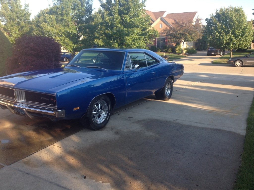

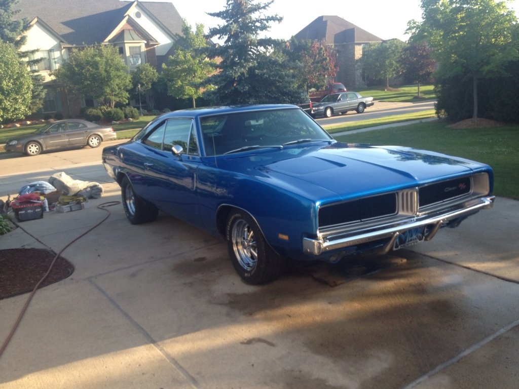

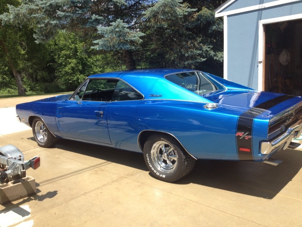

Lastly, the paint. I will also have a professional shop do this. I'm split between two ideas, good thing I still have some time. First idea is to repaint it the way I have it now. I love how it stands out, I get compliments all of the time. Plus it's what drew me to the car in the first place (I'll upload some photos). On the other hand, a buddy of mine drew up some sketches. One of which was the car being black, but along the door and onto the quarter panel what looked to be a tear in the metal (painted on). Green ghost flames were then billowing out and back toward the rear end. We had seen something similar but with blue flames on an old dart and I loved it. I like both so time will tell which way I lean.
A bit of a long winded post, but there ya have it. This by no means will be a quick, cheap, or easy project, but it'll be mine and will be worth it in the end. The body and paint seems to be my biggest obstacle as it will be the most costly area, but it'll get done. I'd love to hear your guy's comments, questions, suggestions, concerns, advice, etc. As I said, I'm 22 and learning as I go and I can learn more from you all than probably anywhere else.
