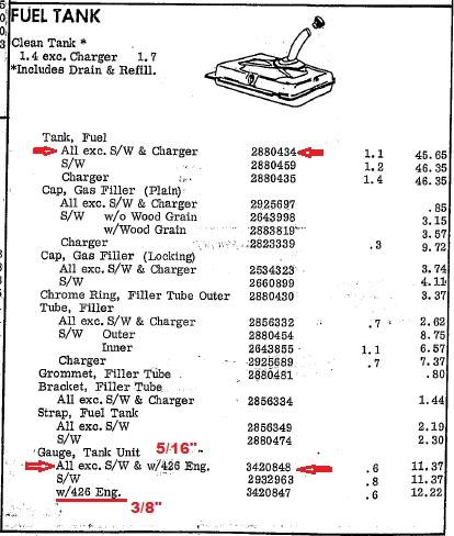

Edit: Only one fuel tank listed for all B-bodies except Charger and wagons: 2880 434. 19 gallons. No return lines or any of that.

440 mag and Hemi cars got the vapor separator for '68.
Possible, but I don't see reference in the parts - maybe the Mopar parts manual would differ. Only thing I see is Hemi and Non for the gauge and that's the diameter of the pick-up tube and fuel lines I believe.
Hard to believe, but my 68 R/T originally came with the 3/8 sender with return fitting, & 5/16 fuel line. When I replaced the tank and lines, I reused the original sender and went with a 3/8 line. Never did have any fuel delivery issues with the 5/16, even at the strip.
I recently installed a new fuel tank and went with 3/8" sender and 1/4" return lines...383 Magnum. What I've read is going with a bigger sender line doesn't make a meaningful difference to performance.
