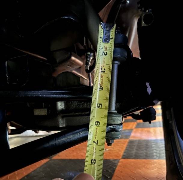

The ones on the car are 6" bolts. They are old, but not sure if original. Rebuild kit comes with 8" bolts and a +2 inch longer spacer, so the bar will hang 2 inches lower.
I want the car to maintain stock appearance and the 8" bolts just don't look right to me.
Can anyone tell me definitively what the original sway bar end link bolt length is on 69 Charger RT?
Wont be able to measure till later today but these are the stock links. Should have a nut on each end, Not just a bolt & nut & spacer....
Sway Bar End Links 1967-69 A/B-Body Front and 1970-74 E-Body Rear, Sway Bar Bushings/End Links/Hardware, 101-5188 Reproduction, NOS and Used Mopar Muscle Car Parts
Ok, mine are bolts so they are not original. They also appear to be shorter than those. The spacers in the middle of mine are only 1-5/8" long. Interesting.

I suppose that makes sense, but I'm only interested in the original factory length, right or wrong.
7” in length total…. Nut on each end. No spacer. It is built into the rod as seen in the pic below and of the kit from MegaParts
