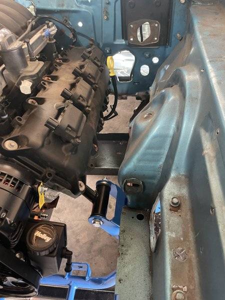

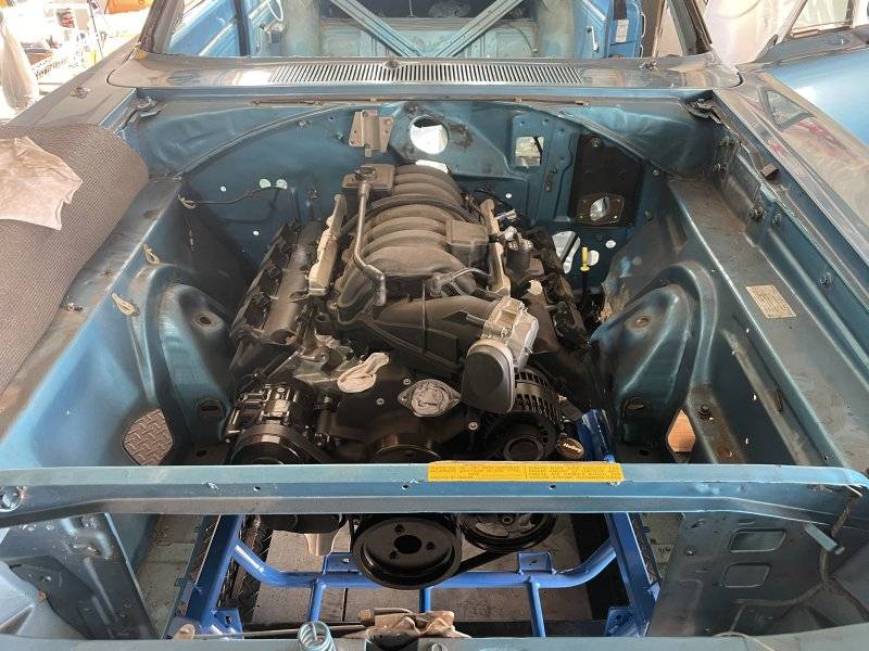

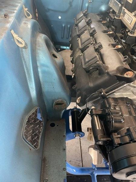

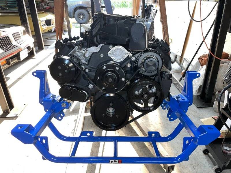

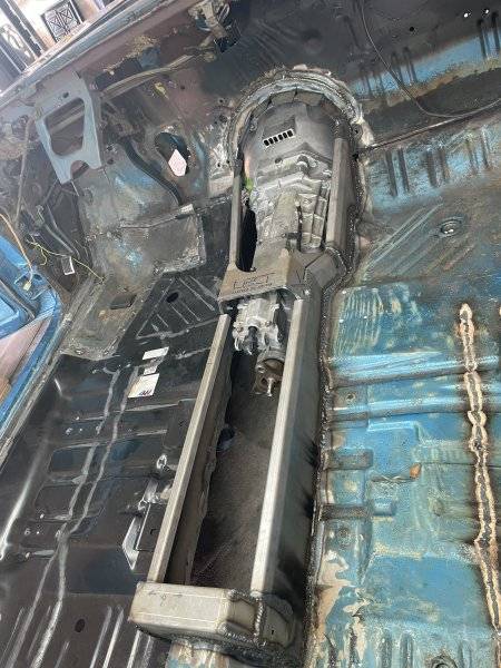

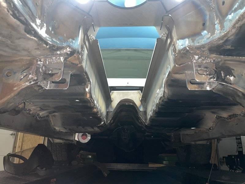

I went with the QA1 coil over K frame. USCT Trans perimeter tunnel, subframe connectors and front & rear torque boxes.
Due to the TR6060 manual trans being used I went with USCT trans mounts as well.

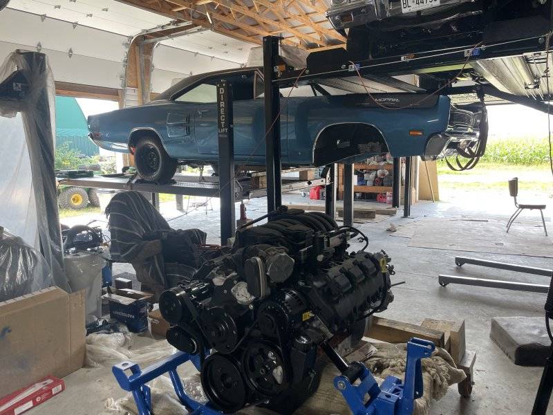

With your drive train coming out of a Charger with the automatic you’ll have a bunch of options for trans mounts. And I don’t think as much trans tunnel modifications as mine.

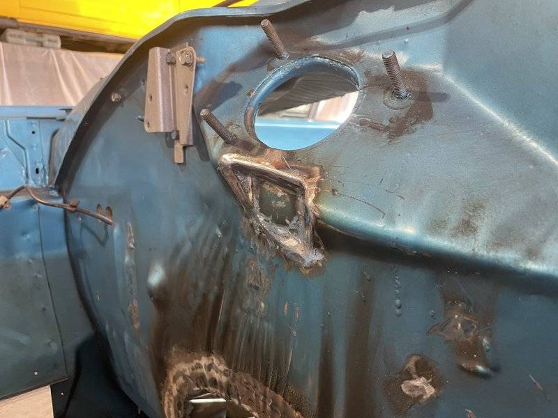

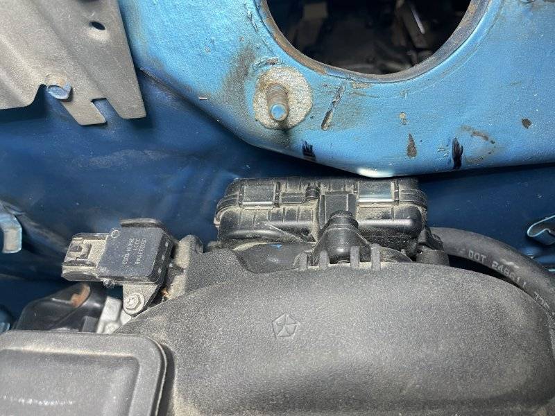

You’ll most likely have to modify your wiper motor bulge on the firewall to clear the SRV control module on the rear of the engine regardless of using the original K frame or aftermarket. I added a few more photos to show some modifications.

I'd love to have a manual but first step is getting this thing rolling. Holley motor mounts allow the engine to be pushed forward 1 inch But your mod of the wiper motor bulge is tidy and accomplishes the same thing.
The good thing about the original K frame is there are a few options for engine mounts.
