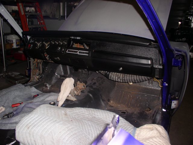

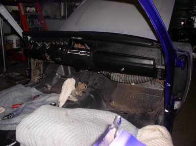

Got the 8 3/4 back Monday; 3.55 suregrip.; springs re-arched, with another leaf added. If we decide to let Dvorack build his 440, and decide what compression and cam, then we can take the 727 to Forte, as he needs the #'s to build the trans and convertor.We pulled the dash, and what a vacuum hose spiderweb...

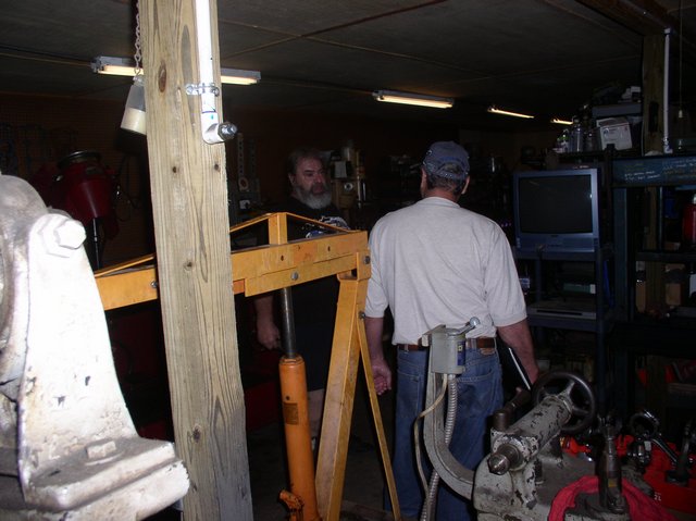

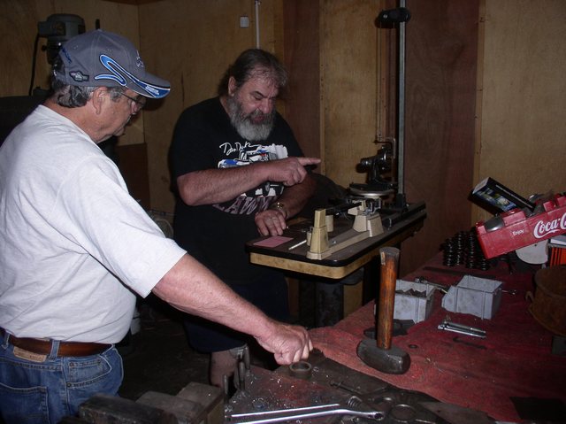

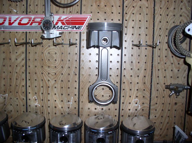

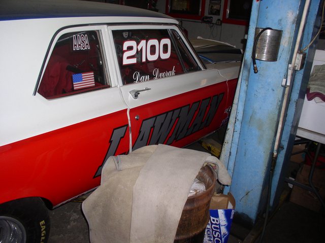

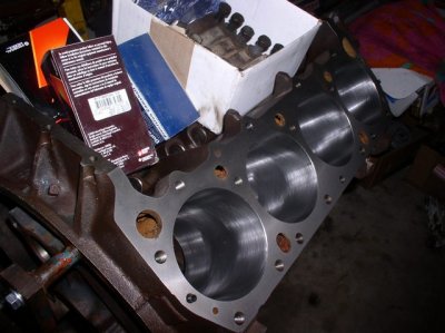

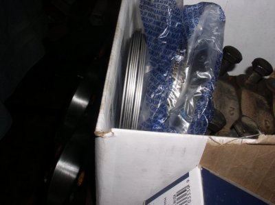

So I don't confuse myself, going to keep drive train in this thread. Buddy brought home the rebuilt 8 3/4, with 3.55 sure, and re-arched springs, with 1 leaf added. Yesterday, drove down to Waldo, and talked to Dan Dvorack for over an hour. I knew about him from him doing my 340 heads in 76. Very very knowledgable man. Buddy was asking ?'s about how he would build the 440. Amazing knowledge (damn he bought back his old "Lawman", his 64 with 426 hemi, factory alum front end, glass 1/2 of regular thickness, etc. He used to hold national record, then sold, then hired to fly up and drive the car, then owner set 2 records, then had people change the set up- no good then.
Lol, there was 3 of us there; after a while, Dan said" I know one of you guys knows more than you are letting on, about this engine, but I can't figure out which one of you it is". Busted. But he asked, did I answer any ? wrong? Nope.
Would you just go ahead and tell me if I'm full of sh# if you thought I was? Nope.
He's getting older, but the knowledge and experience there. When pressed on the cam- heads re-worked for the highest flow, limited to ###, compression, since 93 octane, limited to ###. Limitations dictate the cam. He would only give us the lift (after that, wasting time, no more flow)
It will be a nice idle. But; line up all your buddies, with all the rumpety rump so bad, fenders are about to fall off, and pick the one you want to beat in the next race. lol

Pics not here, Will post later, we ran out of parts for that pos headlight assembly. What a mess, it had been hit, and almost all those weird plastic grommets are missing. Found a local guy to check the heater/a/c box (we sweated pulling it, but what a piece of cake). Can't find wiper grommets. Converting to front disc, can't find a brass bushing between the valve and rear line.
Talked him into talking to the alternator guy I know; we did bypass the ammeter per madelectric(worked good on my 70 Duster); Getting a Denso 90 amp for $125, with older pulley. FYI; Mopar made only 3 alternators; 45 amp, 50/60 amp, then the radial in the late 80's. Then all are Denso. With a tweak, the new Denso's fit old engines, and 60 amps at idle. Running an electronic ignition, a 60 amp may not make it, shutting off the engine at idle. He loved the electronic voltage regulator from Autozone (2 wire, like old 69 back mechanical). And said he had to do the "pull ammeter out of the charging circuit on at least 50 cars (old guy).
