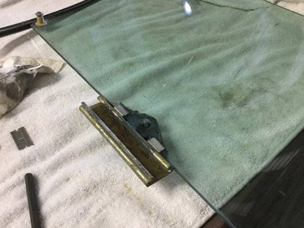

how do I get the regulater
Slide on the bottom of side glass off and does it need to be off to reinstall glass ? Can it be reused it it don't break on removel ?
Pull the plastic rivet and pull it off, they have a gasket like material that protects the glass in the channel that usually falls apart once removed though. I believe RTspecialties sells all the pieces if you break something.
How do I pull it off
I'll have to go look at one, it's been a few years since I did mine. Got a picture of the other side?
As I recall I pinched the plastic rivet with a pair of plyers while gently pushing it out.
It has expanding tangs--no??
