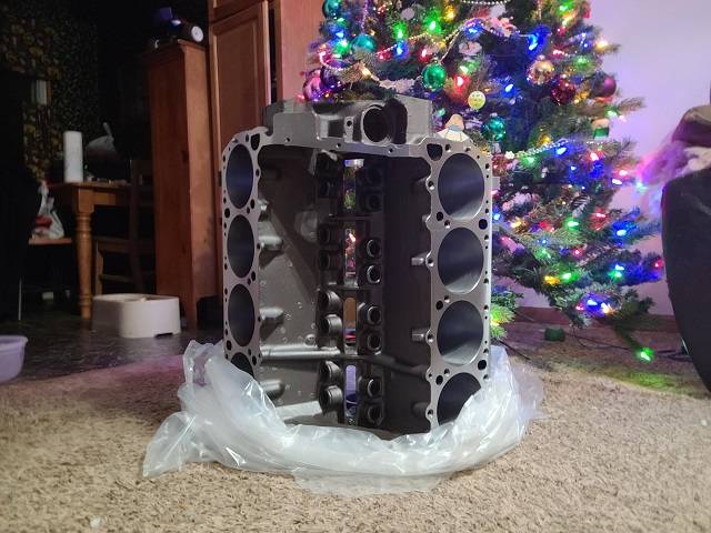

I got an early Christmas Present from the Machine shop today. 512 cubic inches of big block hotness!
Lol, on the carpet and everything. Poor Santa.
Love the 512!! If you have never had one the torque that is at your command is a truly awesome Experience!

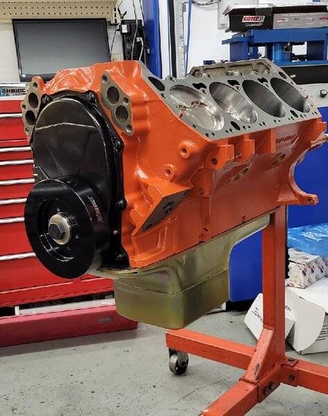

I think We have the same parts from 440 Source and Soon mine will look like that. The rotating assembly is at the machine shop being balanced. 440 Source says it's balanced but I want to be sure.

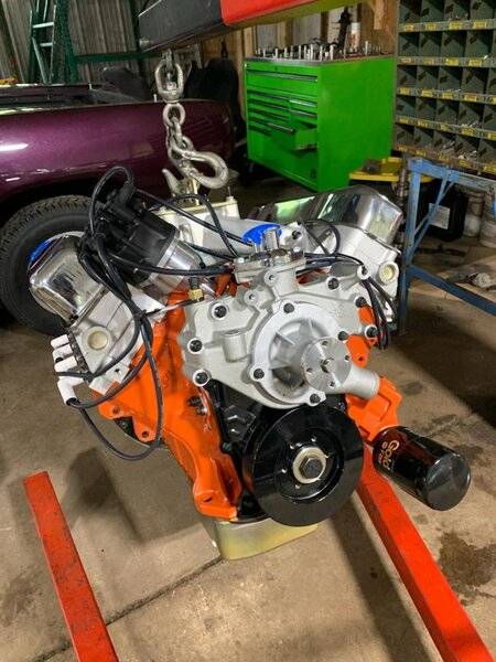

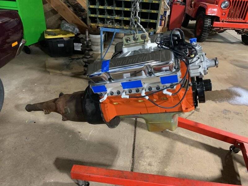

Started putting parts together on the 512. I've degreed the cam, its a
hughes engines flat tappet solid roller. It wasnt the cam I wanted, it's the one they had in stock that they could ship so the machine shop could fit the cam to the cam bearings. It's a decient cam just not what I wanted.

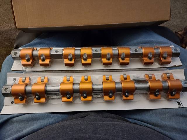

After mounting the Trick Flow heads to the block, I worked on rocker geometry. It was way off with the Harlan Sharpe roller rockers I had on hand. Come to find out Harlan Sharpe makes rockers specific to the Trick Flow heads so I ended up ordering a new set of rockers. The Rocker geometry is now spot on, no shimming required.

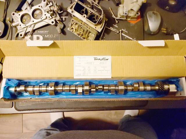

Ok I just wasn't happy with the Cam I had. I also built a profile for the 512 on my desktop dyno program. The cam I had didnt make the torque I wanted but every roller cam I inserted into the equation made more torque off idle to 4500rpm. I bit the bullet and bought a TFS roller cam for the engine. .640 lift 242/247 duration at .050 and a 108 centerline. I hope actual dyno numbers are close to what I got with this cam on desktop dyno. If they are I should be making 650 lbft of torque from 2500 through 4500 and 550HP 6000rpm. I know it will be different but I'm hoping it will be close or better. Now I just have to mortgage the house to afford the roller lifters I want lol.

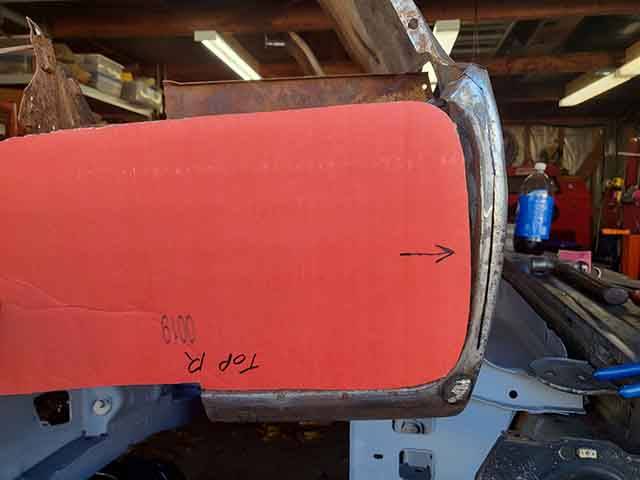

Back to body metal work. Starting to repair the fenders with what I thought was just a few dents and typical rust. Then I found this LOL. The front right fender got smacked in a weird way. I'm not sure how to fix it so I split it up the middle and I'm trying to work each panel separately. I really hope this works and I'll post more as I progress.

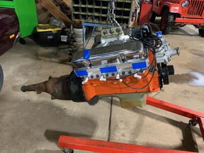

Pushrods installed. That's a good looking engine! now to order the valley pan and get to putting the top half together. I need to find some valve covers as the ones I have are all chrome and I dont want that for this engine. They will be painted Burnt Bronze Cerakote to match the timing cover and brackets.
